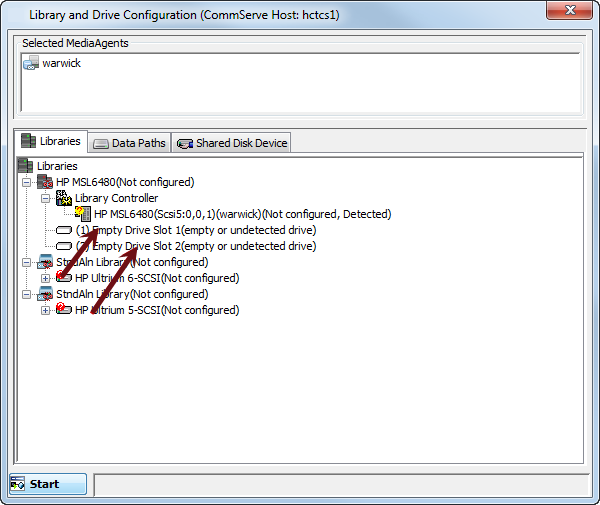

  14. If SCSI 3 drive identification is not supported, the drives appear as standalone drives. Map the drives to the appropriate drive slots.
    1. Physically verify the drives and the appropriate drive slot numbers.
    2. Drag and drop the standalone drives onto the appropriate drives.

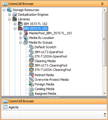

  18. From the CommCell Console, define the barcode patterns that are associated with the storage and cleaning media for each drive type.
    We recommend that you use a specific barcode pattern for the media that is associated with each of the drive types in the library. This helps you to manage and administer the media in the library.
    To define barcode patterns, select the Storage tab on the ribbon, click Media Management, and then select the BarCode Patterns tab on the dialog box that appears.
  19. Create new scratch media pools for the media that are associated with the various drive types.
    1. In the CommCell Console, go to Storage Resources | Libraries | <library>.
    2. Right-click Media By Groups, and then click New Media Group | Spare Media Group.
  20. In the New Media Group dialog box, enter a name into the Group Name box.
    We recommend that you use appropriate names based on the drive type for each of the scratch media pools.
  21. Select the appropriate media type from the Default Media Type list.
  22. Associate the appropriate barcode pattern in each of these scratch media pools.
  23. Create new cleaning media pools for the cleaning media associated with the various drive types.
    We recommend that you use appropriate names based on the drive type for each of the cleaning media pools.
  24. Associate the appropriate barcode pattern in each of these cleaning media pools.
    The sample image shows the scratch and cleaning media pools with appropriate names associated with drives used in this example.
    med_grp_pools
