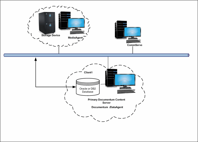

Single-Server Environment
A single Repository is supported in a single-server, all-in-one configuration. When all Documentum components are installed on the same computer, the Documentum agent is sufficient to back up all components.
The illustration below depicts a possible example of how you could configure your environment. Keep in mind that the configuration is flexible and that you should set up your client computers and install your components according to your needs and available resources.
In the single-server configuration, the Documentum agent is installed on the same computer as the Primary Documentum Content Server to protect these components:
  • Storage Areas
  • Database (Oracle or SQL)
  • Full-Text Indexes (optional)
Contrast a single-server environment with a Distributed-Server Environment.

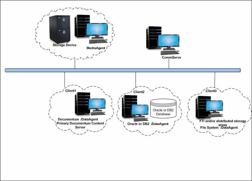

In addition to a single-server environment, a single Repository is supported in a distributed-server configuration. When the components are installed in a distributed setup, the File System agent or database agents (Oracle or SQL) need to be installed according to the configuration.
The illustration below depicts a possible example of how you could configure your environment. Keep in mind that configuration is flexible and that you should set up your client computers and install your components according to your needs and available resources.
In this configuration, these components are installed on three client computers as follows:
  • Client 1
    This is the Primary Content Server where the Documentum agent must be installed to protect the Storage Area residing on the server.
  • Client 2
    On this computer, an Oracle or a SQL agent is installed to protect their respective database components.
  • Client 3
    On this computer, the File System agent is installed to protect the following components:
    • Distributed Storage Areas
    • Full-Text Index
Contrast this with a Single-Server Environment where all Documentum components are installed on the same computer and the Documentum agent is sufficient to back up all components.
