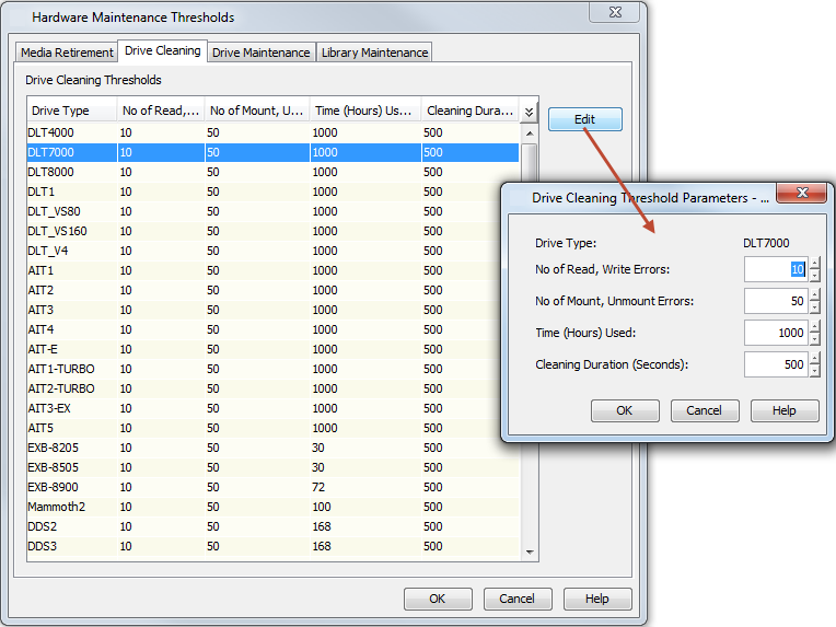

Drive Cleaning Threshold Parameters
To get optimal performance from your drives, you need to clean them periodically. The Drive Cleaning Threshold Parameter keep track of various types of drive events that can occur before a drive is cleaned or fixed.
You can set event thresholds for each drive type (for example, DLT 7000). In other words, you can decide how many events of each type can occur before a drive exceeds its capacity for reliable operation and must be cleaned or fixed. Such events include the number of software and hardware errors, and the number of hours that the drive has been used.
When the number of events exceeds a preset threshold, the system performs the following operations:
  • Sends a message to the Event Log.
  • If the Enable Auto-Cleaning when threshold exceeds option is enabled in the Drive tab of the Library Properties dialog box, the Cleaning Required option is set to Yes in the Status tab of Drive Properties dialog box.
  • Generates the Threshold Exceeded alert, if the system is configured to do so.
If Mark Library/Drive broken when error thresholds exceeded is selected on the Drive tab in the Library Properties dialog box, then the following changes occur on the Status tab in the Drive Properties dialog box:
  • The Status is changed to Offline.
  • The Offline Reason indicates that the drive cleaning threshold was exceeded.
  • The Broken status is changed to Yes.
The system automatically cleans the drive when the drive cleaning threshold parameters are exceeded, if the Enable Auto-Cleaning option for the library is enabled. For information on the auto-cleaning option, see Enable Automatic Drive Cleaning.
The actual usage values for the libraries and drives that are attached to a MediaAgent can be viewed by generating the Library and Drive Report.
The threshold and usage information for each drive can be viewed on the Odometer tab of the Drive Properties dialog box.
Refer to the manufacturer's documentation for the recommended cleaning criteria for each drive type.
Modifying Drive Cleaning Threshold Parameters
  1. On the ribbon in the CommCell Console, click the Storage tab, and then click Hardware Maintenance.
  2. Click the Drive Cleaning tab in the dialog box that appears.
  3. Click the drive type that you want to modify, and then click Edit.
  4. In the Drive Cleaning Threshold Parameters dialog box that appears, change the appropriate threshold values, and then click OK.
  5. Click OK in the Hardware Maintenance Thresholds dialog box to save the changes.
drv_clean_thresh_param

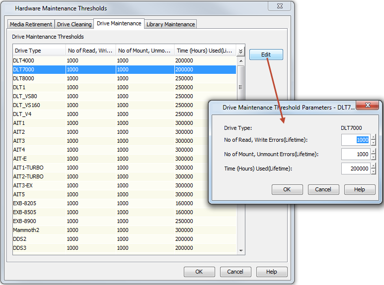

Drive Maintenance Threshold Parameters
To get optimal performance from your drives, you must replace them whenever necessary. Drive Maintenance Threshold Parameters keep track of various types of drive events (for example, software and hardware errors, read operations, and so on) for each drive.
You can set event thresholds for each drive type (for example, DLT 7000). In other words, you can decide how many events of each type can occur before a drive exceeds its capacity for reliable operation. When the number of events exceeds a preset threshold, the system performs the following operations:
When you replace a drive, you must mark it as replaced. This resets the appropriate event counters to zero.
Refer to the manufacturer's documentation for the recommended maintenance criteria for each drive type.
Modifying Drive Maintenance Threshold Parameters
  2. Click the Drive Maintenance tab in the dialog box that appears.
  4. In the Drive Maintenance Threshold Parameters dialog box that appears, change the appropriate threshold values, and then click OK.
drv_maint_thresh_param

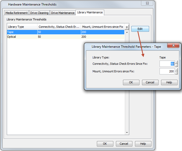

Library Maintenance Threshold Parameters
To get optimal performance from your libraries, you must replace them whenever necessary. Library Maintenance Threshold Parameters keep track of various types of library events (for example, software and hardware errors) for each library.
You can set event thresholds for each library type (for example, tape). In other words, you can decide how many events of each type can occur before a library exceeds its capacity for reliable operation. When the number of events exceeds a preset threshold, the system performs the following operations:
  • If Mark Library/Drive broken when error thresholds exceeded is selected on the Drive tab in the Library Properties dialog box, the following changes occur on the Status tab in the Library Properties dialog box:
    • The Offline Reason indicates that a threshold was exceeded.
Refer to the manufacturer's documentation for the recommended maintenance criteria for each library type.
Modifying Library Maintenance Threshold Parameters
  2. Click the Library Maintenance tab.
  3. Click the library type that you want to modify, and then click Edit.
  4. In the Library Maintenance Threshold Parameters dialog box that appears, change the appropriate threshold values, and then click OK.
lib_maint_thresh_param

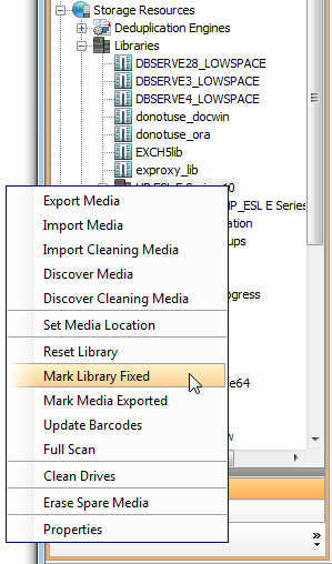

Marking a Library Fixed
When you fix or replace the library, you must mark the library as fixed. This resets the counters that keep track of library events and brings the library online.
  1. From the CommCell Browser, right-click the library that you have fixed, and then click Mark Library Fixed.
  2. Click Yes in the message that appears.
    This resets the counters for the library.
mark_lib_fixed
