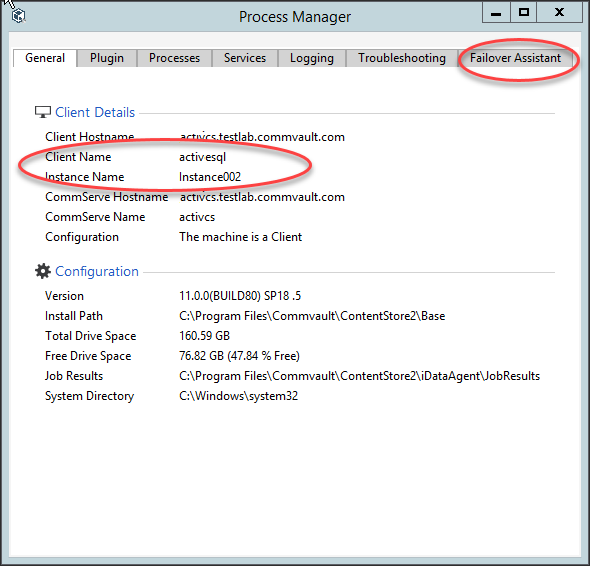

  3. Click Commvault > Process Manager. Open the Process Manager associated with the SQL client.
    The SQL client will have the Failover Assistant tab as shown in the following sample image.

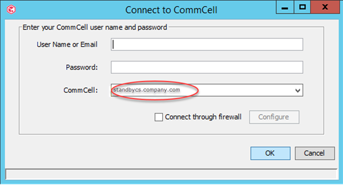

  • After a successful failover, make sure to open the CommCell Console and/or Command Center from the new active CommServe host. Make sure to connect to the currently active host in the CommCell box displayed in the Connect to CommCell dialog box.
