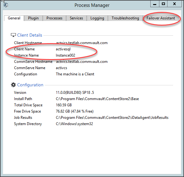

Click Commvault > Process Manager. Open the Process Manager associated with the SQL client.
The SQL client will have the Failover Assistant tab as shown in the following sample image.
