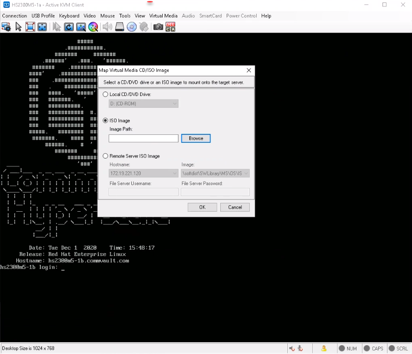

  3. Access the node using the KVM management console in your environment.
  4. Map the downloaded ISO image as a virtual media from the KVM Management console.
    Click here to view a sample image.

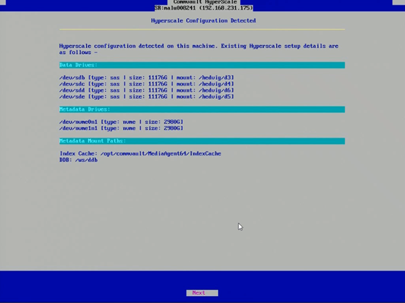

  6. The HyperScale Configuration Detected screen is displayed.
    Recovering an HyperScale X Appliance Node (1)
    Choose Next.

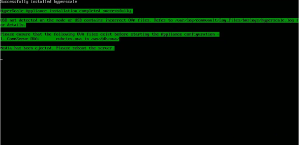

    The installation process will be started. This process will take some time to complete.
    The following message will be displayed once the installation is complete.
    Recovering an HyperScale X Appliance Node (3)
