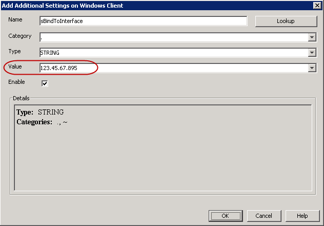

  4. Click the Additional Settings tab and then click Add.
  5. In the Name field of the Add Additional Settings dialog box, type sBindToInterface. The Category and Type details will be automatically populated.
  6. In the Value box, type IP address or host name of the interface to which all services should bind.
  7. Click OK to the additional setting configuration.
  8. Click OK.
  9. Stop and start the services.
