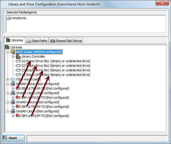

If the library does not support SCSI 3 drive identification, the system detects the library with Empty Drive Slots and the drives as StndAln Library. Do either of the following:
Right-click the library, point to Advanced Options, and then click Exhaustive Detection.
Physically verify the drives and the appropriate drive slot numbers, and then drag and drop the standalone drives onto the appropriate drives.
