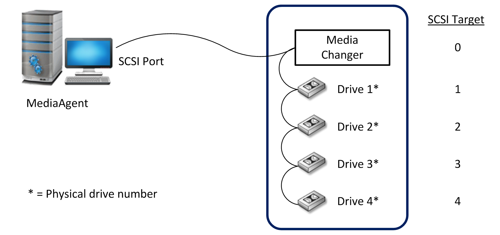

Single Library Setup
SCSI Port
In this configuration, a single SCSI port (that is, port 1) connects the MediaAgent to the library and its media drives (four in this case). The port number can vary from system to system, and depends on whether any other SCSI devices are already installed. For example, your system might have a CD-ROM drive assigned to a target on SCSI port 0.
SCSI Target
When we assigned SCSI targets in this example, we started at target 0, and then proceeded in ascending order, matching the target number to the physical drive location. We could have started at a higher number, provided we kept an ascending sequence (for example, 2, 5, 6, 8, and 9).

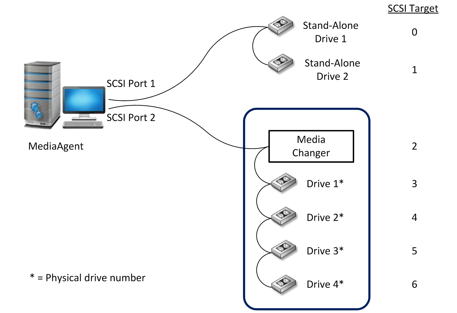

Single Library, Two Stand-Alone Drives Setup
SCSI Port
In this configuration, SCSI port 1 connects to two stand-alone drives. SCSI port 2 connects to a library and its media drives. We use the lower numbered port (that is, port 1) for the stand-alone drives and the higher numbered port (that is, port 2) for the library.
SCSI Target
When we assigned SCSI targets in this example, we started at target 0, and then proceeded in ascending order, keeping all targets unique across the SCSI ports.

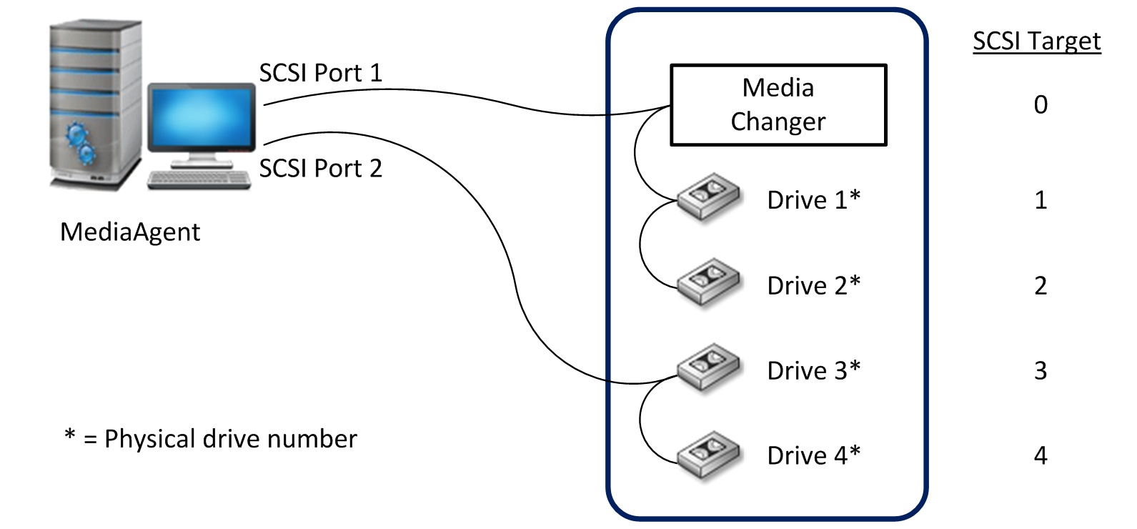

SCSI Port
In this configuration, two SCSI ports connect the MediaAgent to the library and its media drives. We must connect the lower port number (that is, port 1) to the media changer.
SCSI Target
When we assigned SCSI targets in this example, we started at target 0, and then proceeded in ascending order, which keeps all of the targets unique across the SCSI ports. We maintained this consistency across SCSI port 2 where we started the target numbers at 3.

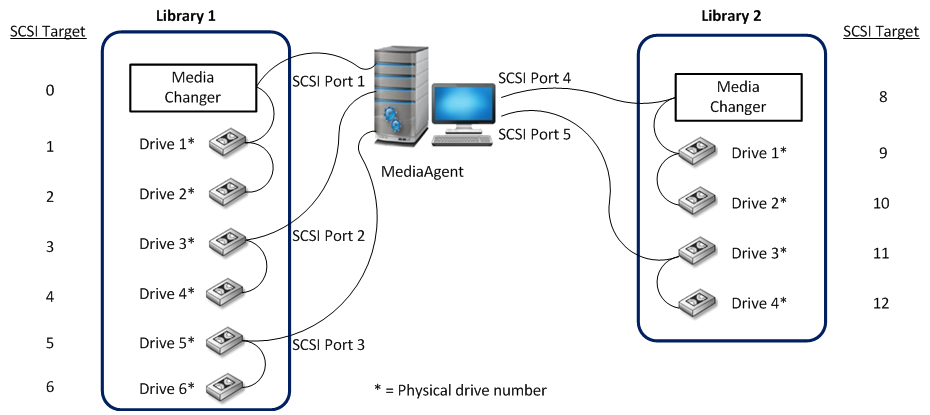

Multiple Library Setup
SCSI Port
In this configuration, five SCSI ports connect the MediaAgent to two libraries with two media drives on each port. We connected the lowest port number to the media changer in the first library and drives 1 and 2. (We could have chosen either library to be first.) Then we connected the next ports in ascending sequence by port number to ascending drive pairs: port 2 to drives 3,4 and port 3 to drives 5,6. When all of the drives in the first library were connected, we connected the second library. With two ports remaining, we connected the lower number port (that is, port 4) to the media changer and drives 1 and 2. We connected the last port (that is, port 5) to the two remaining drives, drives 3 and 4.
SCSI Target
When we assigned SCSI targets in this example, we assigned the media changer the lowest target number and proceeded in ascending order, which keeps all of the targets unique across the SCSI ports. We did not use target 7 because this target 7 is normally reserved for the SCSI adapter.
This example assumes a wide SCSI implementation. If we had used narrow SCSI, which only has 7 available targets, we would have restarted the target numbering sequence on Library 2 using targets 0 through 4.
