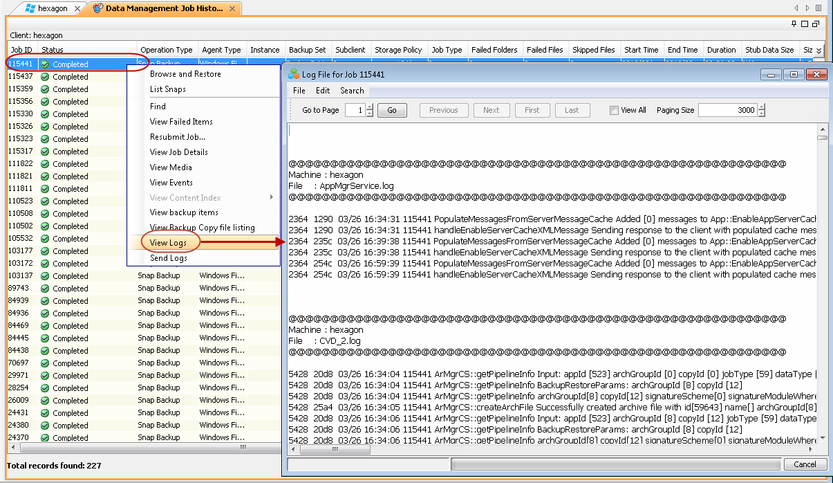

You can view the log files of a job in the Job History window.
Use the following steps to view the log files of a job (from the Job History window of a client, as an example):
From the Job History window, right-click the job and then click View Logs.
The Log File for Job nwindow appears, displaying the contents of the log file related to the selected Job History.
Click Cancel.

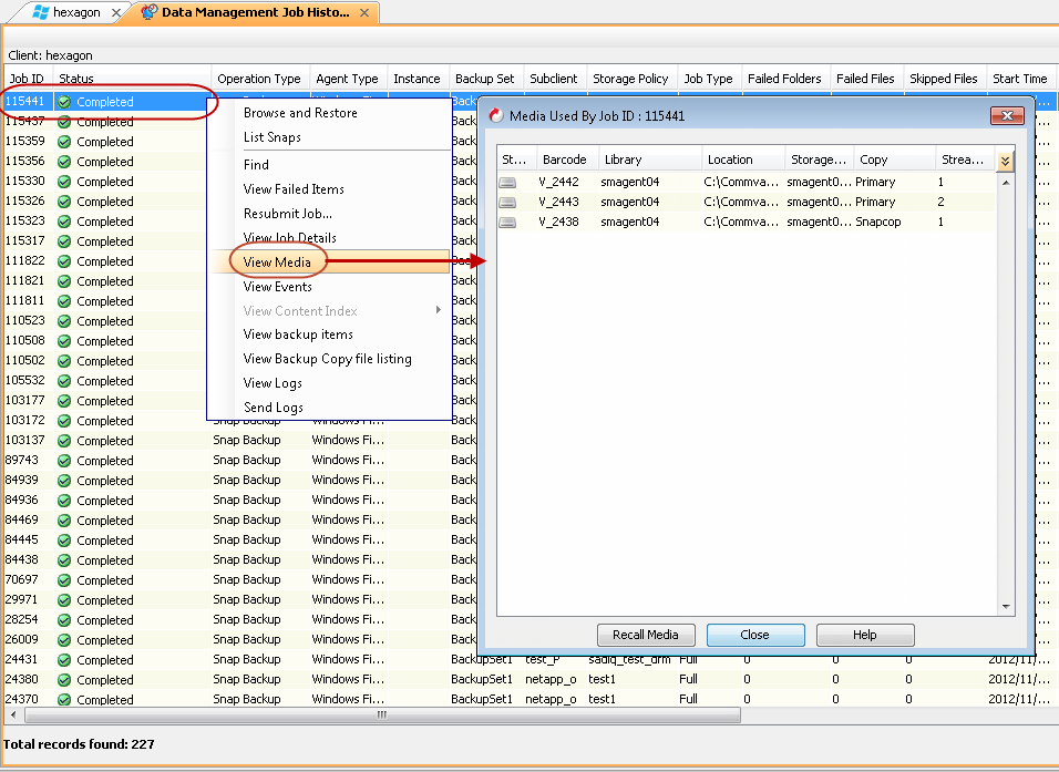

Viewing the Media for a Job
You can view the media associated with a specific job in the Job History window.
Use the following steps to view the media associated with a job (from the Job History window of a client, as an example):
From the Job History window, right-click the job and then click View Media.
The Log File for Job nwindow appears, displaying the contents of the log file.
Click Close.

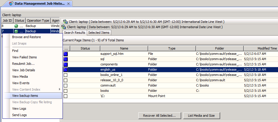

From the Job History window, right-click the job and then click View Backup Items.
The Backup File List nwindow appears, displaying the items that were successfully backed up.

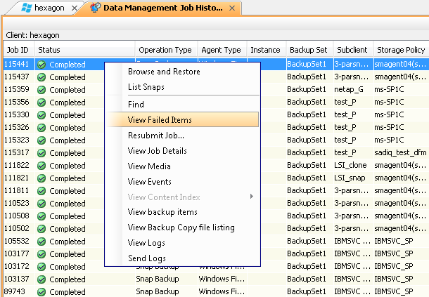

Viewing Failed Items for a Job
You can identify the number of failed operations for a job from the Job History window. These include individual files that may fail the job even though a particular job completed successfully. Some items fail because they are locked by the operating system or application and cannot be opened at the time of the backup operation. This often occurs with certain system-related files and database application files.
Use the following steps to view the list of items that failed to backup for a job (from the Job History window of a client, as an example):
From the Job History window, right-click the job and then click View Failed Items.
The Unsuccessful Backup Files window appears, displaying the items that failed to backup.
Click Close.

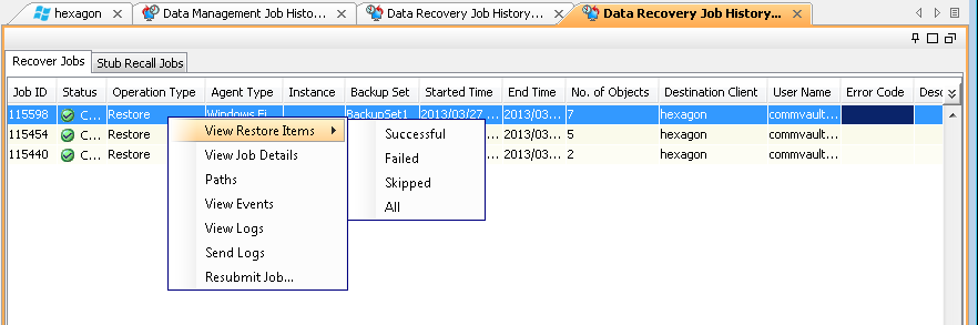

Use the following steps to view the restored items associated with a job:

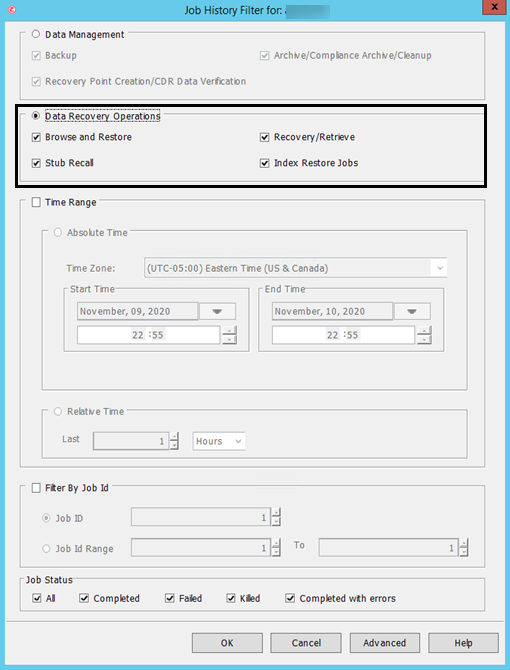

From the CommCell Browser, right-click the appropriate entity and click View > Job History.
The Job History Filter dialog box appears.
From the Job History Filter window, select Data Recovery Operations.
From the Job History window, right-click the job and then click View Restore Items | All.
The Restore Files window appears, displaying the files that were restores.
Click Close.

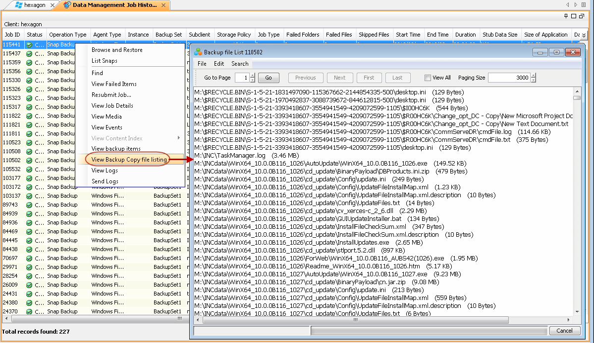

Viewing Job History for Backup Copy Jobs
The Backup Copy Job History can be viewed from the CommServe, client, Agent, Instance, BackupSet and Subclient levels for all backup jobs. You can view detailed information about backup copy jobs in the Job History window.
The section below provides the steps to view the backup copy job history of a Client:
In the Job History Filter dialog box, click Advanced.
In the Data Protection History Advanced Filter dialog box, click the Include Backup Copy Jobs check box and then click OK.
From the Job History window, right-click the job and then click View Backup Copy File Listing.
The Backup Copy File List window appears, displaying detailed job history.

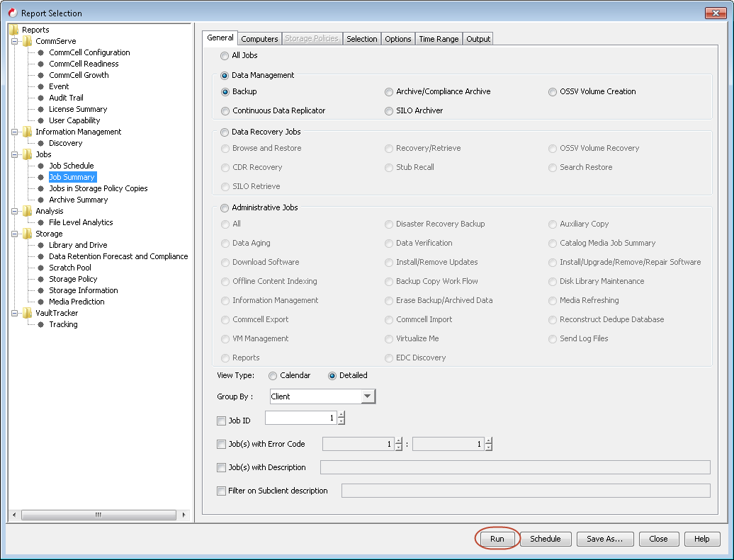

Job Summary Report
The Job Summary Report displays all data management, data recovery, and administrative jobs that ran in the CommCell during a specified period of time. The report also includes information about all media options. Please refer Job Summary Report for details.
Use the following steps to generate Job Summary Reports:
From the Reports menu in the CommCell Console, click Summary.
Select suitable options and click Run.
Job Summary Report appears in your default browser.
