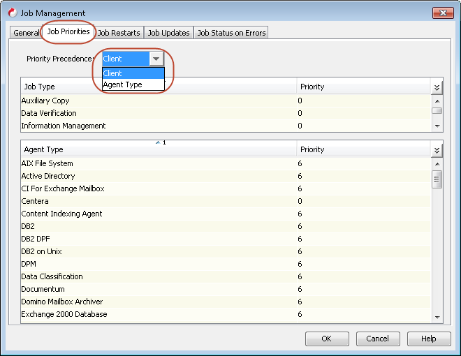

For a Client
On selecting Client priority precedence, the second digit represents Client priority and third digit represents Agent priority.
Use the following steps to set Client Priority Precedence:
From the CommCell Console ribbon, on the Home tab, click Control Panel.
Under Data, click Job Management.
Click the Job Priorities tab.
Select Client from the Priority Precedence box.

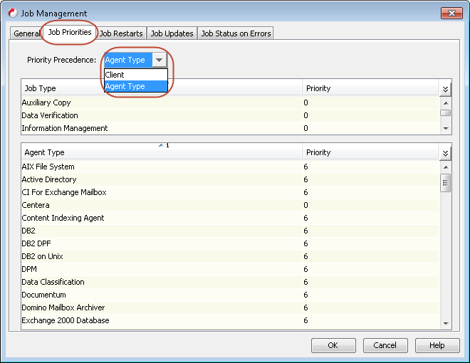

For an Agent
On selecting Agent Type priority precedence, the second digit represents Agent priority and third digit represents Client priority.
Use the following steps to set Agent Priority Precedence:
Select Agent Type from the Priority Precedence box.

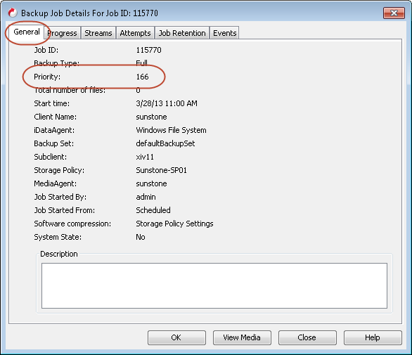

You can view the priority assigned to a specific job by viewing the details of the job.
Use the following steps to view priority of a specific job:
From the CommCell Console toolbar, click Job Controller.
In the Job Controller pane, right-click an active job and select Detail.
You can view the Priority of the selected job under the General tab.

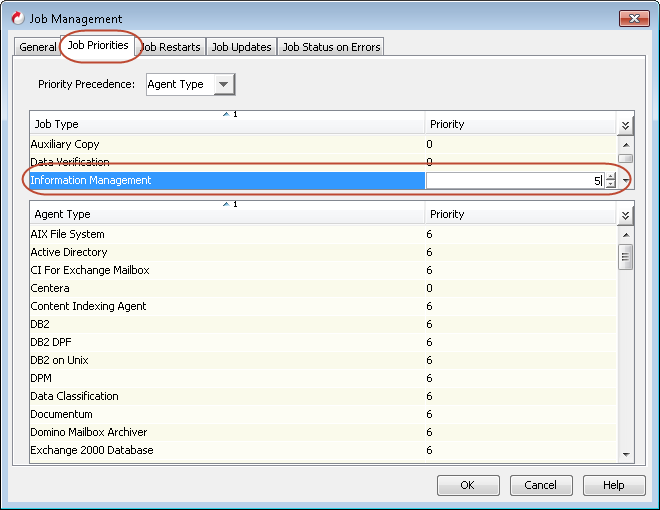

Use the following steps to change the priority of administration jobs:
Select a Job Type and enter the priority value in the Priority column.
The lower the value, the higher the priority of the agent.

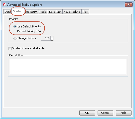

From the dialog box of an appropriate operation (such as backup, restore or auxiliary copy) click Advanced.
From the resulting dialog box click the Startup tab.
Select Use Default Priority.
To start the job in a suspended state, select the Startup in suspended state check box.
