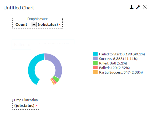

Donut charts display percentage data in a semi-circle, much like a pie chart with the center removed.
Drop Measure
By default, the Drop Measure will show a count of the field that you selected for the Drop Dimension. You can graph something other than the default, such as the number of failed objects.
Drop Dimension
In a donut chart, the dimension can include alphabetic information, such as a job status or agent name.
