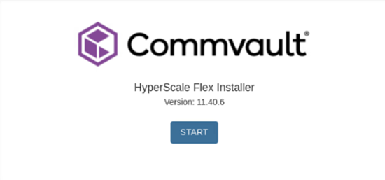

  1. Log on to the node using the system console as described in Setting up a Static IP For IPMI. (Do not use PuTTy / SSH to setup the nodes.)
    # hssetup
    The HyperScale Flex Installer page appears.
    hs_flex_install1
  3. Click Start.
    robo_linux_install1

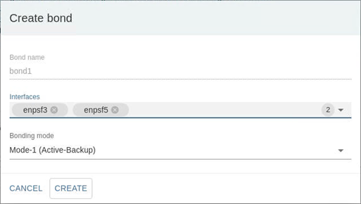

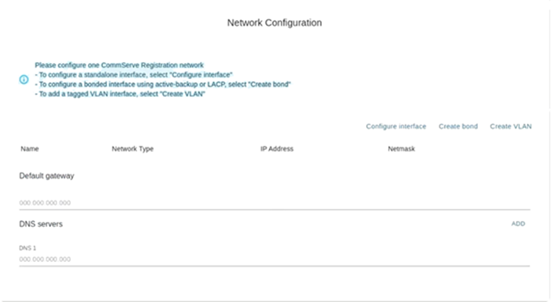

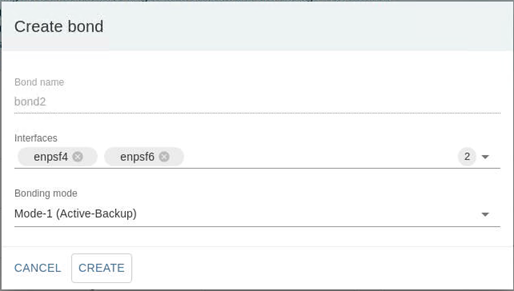

  4. Create a data protection interface bond as follows:

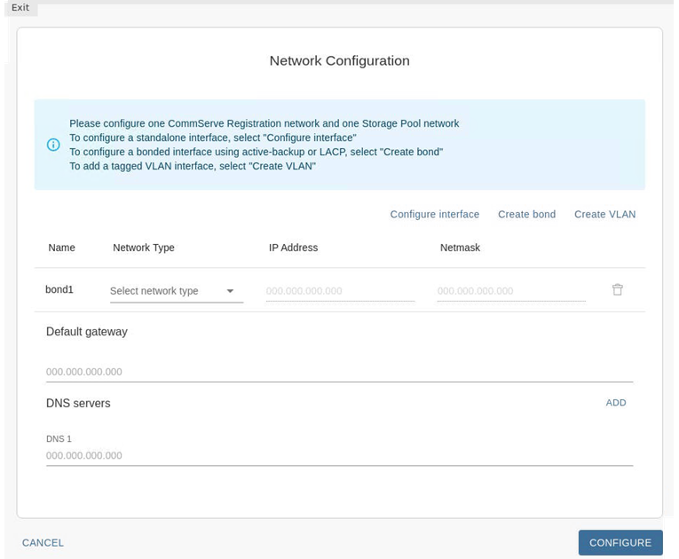

    1. Click Create bond.
      Tagged vLAN and Bonding (30)
    2. From the Interfaces list, select the data protection interfaces. (enpsf3 or enpsf5)
    3. From Bonding mode list, select either active-backup (Mode 1) or LACP (Mode 4).
    4. Click CREATE.
      Tagged vLAN and Bonding (17)

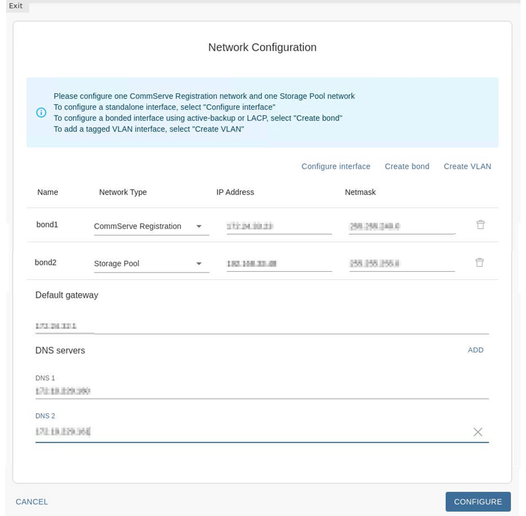

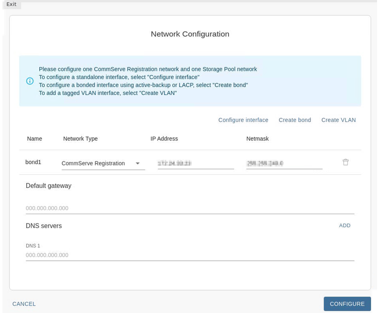

    5. From the Network Type list, select CommServe Registration
    6. Add the IP Address and Netmask in the respective boxes.
      LACP Bonding (1)

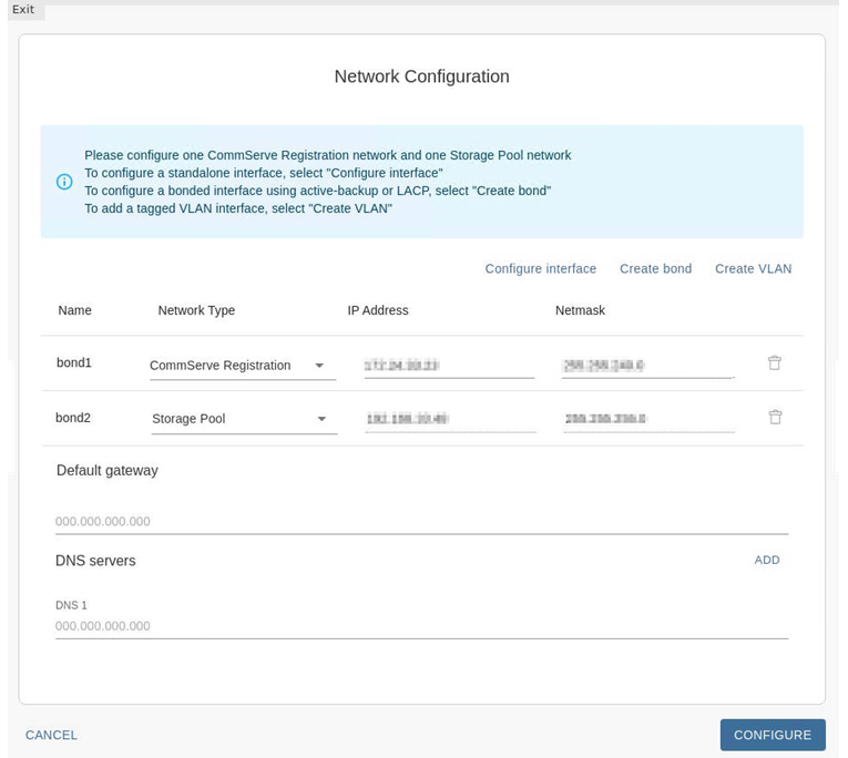

  5. Configure the storage pool interface (bonded) as follows:
      Tagged vLAN and Bonding (31)
    2. From the Interfaces list, select the 2 interfaces that will form the storage pool bond. (For example, enpsf4 and enpsf6 .)
    4. Click CREATE.
    5. From the Network Type list, select Storage Pool. This interface will be be used exclusively for communication and replication between the HyperScale nodes.
      LACP Bonding (2)
      LACP Bonding (3)
    3. Click CONFIGURE.
      LACP Bonding (7)

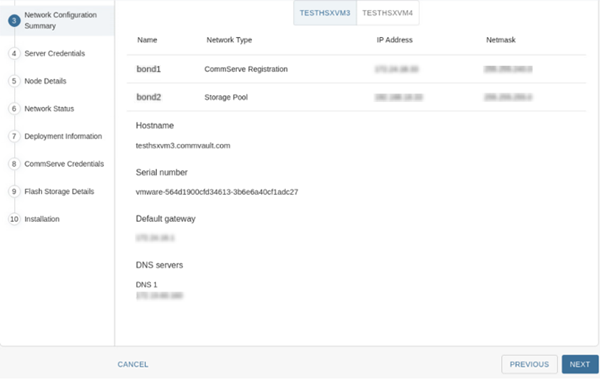

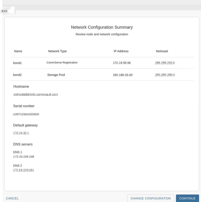

  7. Verify the network configuration and then click CONTINUE. Verify the following information.
    • IP address and netmask for the data protection interface is accurate.
    Tagged VLAN (7)

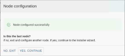

  8. Click one of the following:
      Repeat the steps (step 1 through 6) from another node.
      The Setup Type page appears.

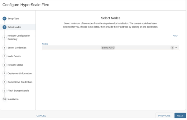

  10. Select the nodes as follows:
    3. Click NEXT.
    4. Click NEXT.

  11. Verify the summary for each node by clicking the tab associated with each node. Ensure that the nodes are accurately configured and then click NEXT.

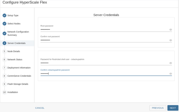

  12. Add the following information:
    2. In the Password for Restricted shell user - cvbackupadmin and Confirm cvbckupadmin password boxes, type a secure password for the cvbackupadmin user.
    3. Click NEXT.

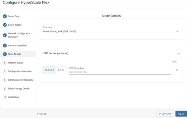

    1. From the Time zone list, select the time zone in which the nodes are located.
    2. Optional: In the NTP Server/Pool box, type the IP address of the NTP server or NTP pool if available.
    3. Click NEXT.

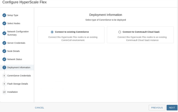

    The Credentials page appears.
    hs_flex_install_10

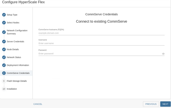

  16. To connect to the CommServe, provide the following details:
    2. In the Username and Password boxes, enter the CommCell user account credentials (not an Active Directory (AD) user account) to connect to the CommServe server, and then click Next.

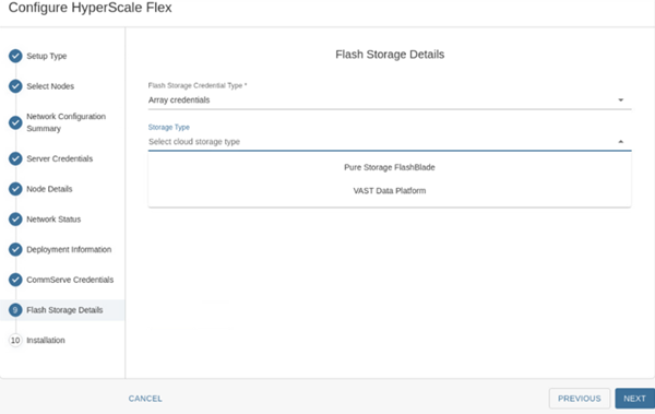

  17. Add the following information:
    1. From the Flash Storage Credential Type list, select Array credentials.

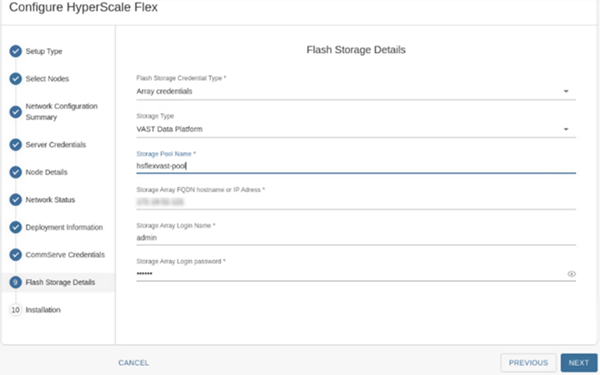

    2. From Storage Types list, select the cloud storage (Pure Storage Flashblade or VAST Data Platform) that you want to configure.
    3. In the Storage Pool Name box, type a name for the cloud storage pool.
    4. In the Storage Arry FQDN hostname or IP address, type the hostname of IP address of the cloud storage array.
    5. In the Storage Array Login Name box, type the user account to access the cloud storage array.
    6. In the Storage Array Login Password, enter the password for the cloud storage user account.
    7. Click NEXT.

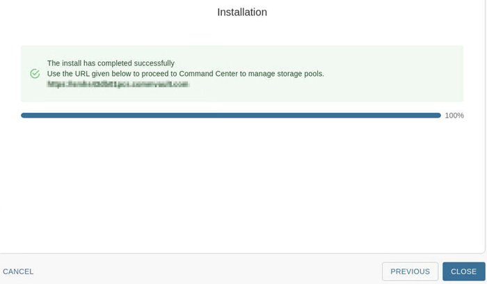

    embd_SetupCS2 (1)
  18. Click CLOSE.
