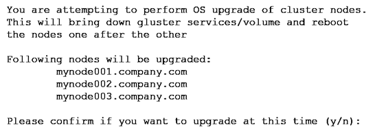

    Installing Operating System Updates (1)
    Important
    Make sure that all the nodes in the cluster are listed.
  7. Type y and press Enter to continue.

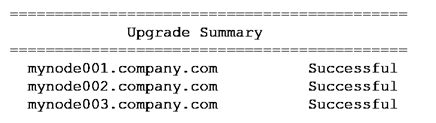

  10. Once the installation is completed, check the status of the installation using the following command:
    ./cvupgradeos.py -status
    This will display a message similar to the following:
    Installing Operating System Updates (4)
    If there is a failure, investigate the reason for the failure in /var/log/commvault/Log_Files/cvupgradeos.log. Correct the issue causing the failure and then rerun cvupgradeos.py to install the updates in the failed node.
