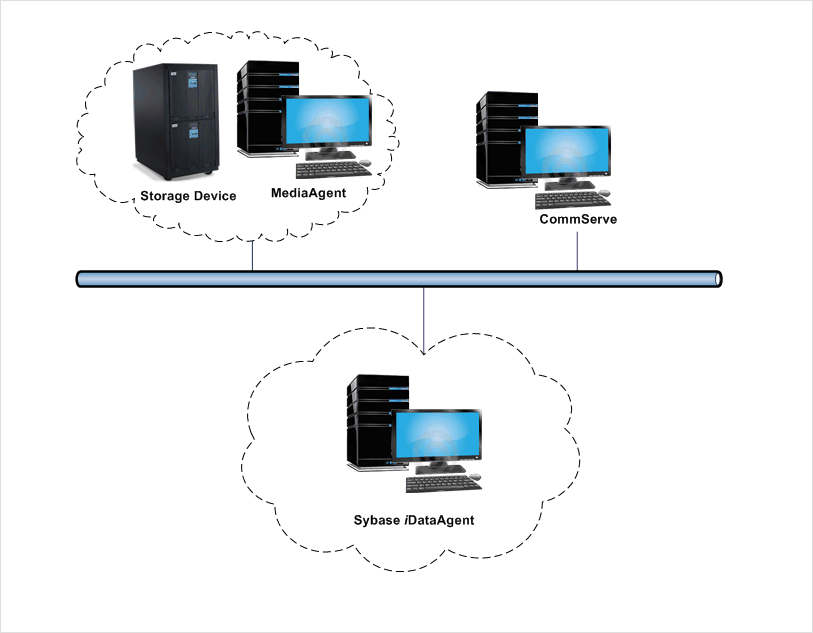

The Sybase Agent provides a unique, simplified end-to-end backup and recovery solution for Sybase system and user databases in your enterprise. In addition to complete protection of the system databases that contain user database characteristics, file locations, and so on, the agent also provides granular backup and recovery of your enterprise's data, related administration files, and transaction logs.
Key Features
A Full Range of Backup and Recovery Options
The Sybase Agent provides the flexibility to backup the Sybase server, which consists of system and user databases in different environments. This is essential since the Sybase system and user databases are subject to constant changes.
You can perform a full or transaction log backup of the entire Sybase server at any time. The following section describes the backups that can be performed in different environments.
