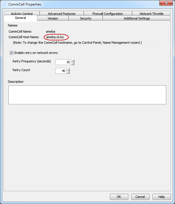

Check the configuration in the CommCell Console for the CommServe, MediaAgent and the Client with issues. Different phases of the backup or restore operations require reviewing different communications paths. Also, check the registry entries on the CommServe, MediaAgent and the Client.
The example below will cover the CommServe and the client computers.
From the CommCell Browser, right click the CommServe and click Properties. Check the CommCell Host Name.
From the CommCell Browser, right click the Client computer and click Properties. Check the host name and CommServe host name.

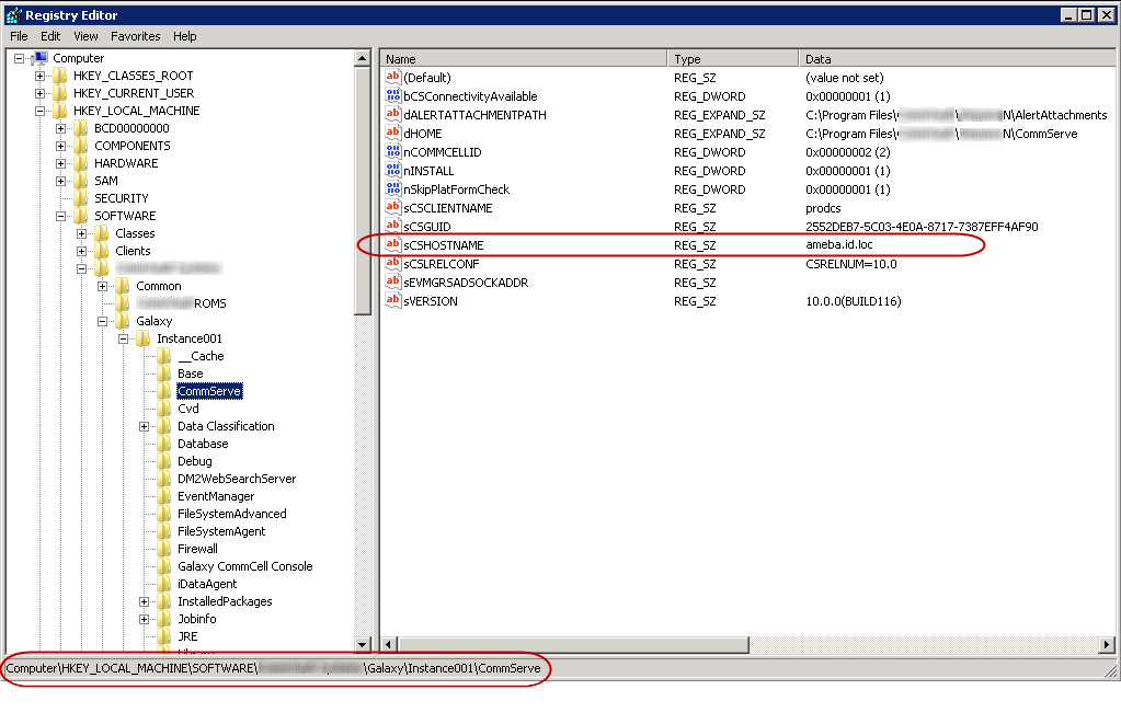

The registry on the CommServe (CS) will have two locations that show the CS Host Name when it also has a Client (CL) installed.
For the CommServe Name used by the Clients other then the CommServe Client the registry entry for sCSHOSTNAME is located under \HKLM\Software\Commvault Systems\Galaxy\Instance001\CommServe
For the CommServe with a Client (CL) File System Agent installed, the name is hosted at this registry location.

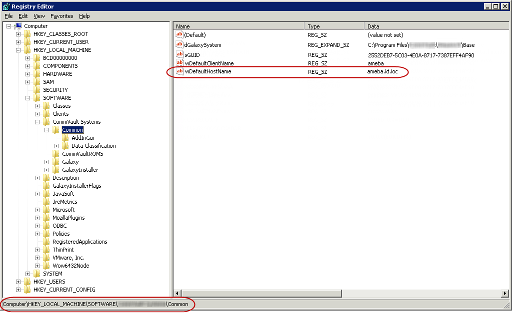

Registry entry for wDefaultHostName is located under \HKLM\Software\Commvault Systems\Common

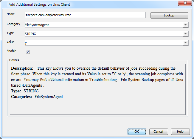

To view the "Completed w/ one or more errors" message in the Job History in the Scan phase, follow the steps given below:
From the CommCell Browser, navigate to Client Computers.
Right-click the <Client> and click Properties.
Click Advanced and then click Additional Settings tab.
Click Add.
In the Name field, type sReportScanCompleteWithError.
In the Value field, type y or Y to enable the error message display or n or N to disable the error message display..

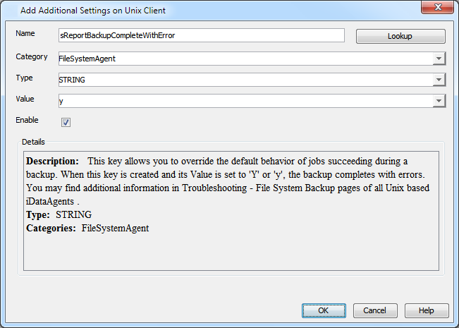

To view the "Completed w/ one or more errors" message in the Job History after a backup, follow the steps given below:
Click Add.
In the Name field, type sReportBackupCompleteWithError.

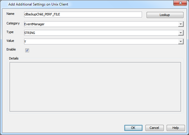

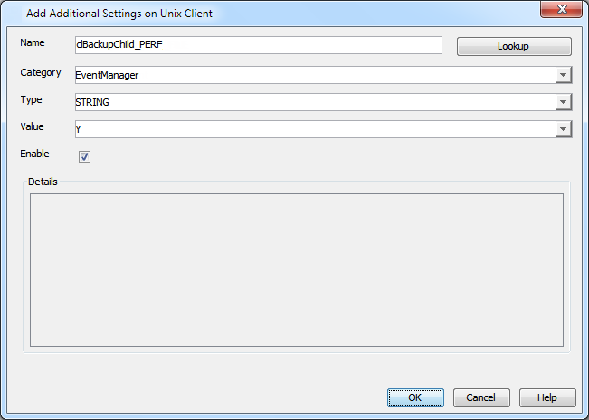

Displaying Performance Details of a Backup Job
Click Add.
In the Name field, type clBackupChild_PERF.
In the Value field, type Y.
Displaying Performance Details for Each File in a Backup Job
In addition to viewing the performance details for a backup job, you can also view the performance details of each file in the backup job. Note that the file names are not printed in the log.
Click Add.
In the Name field, type clBackupChild_PERF_FILE.
This additional setting should be used together with the clBackupChild_PERF additional setting.

UFS0005: After an authentication failed error if a MediaAgent or a client cannot communicate with CommServe it will disable itself immediately
Symptom:
During Backup:
- Error Code19:1327
Attempt start error: [...]- Error Code 9:90
Authentication failed for host [...]. Network password does not match.- Error Code 40:52
Failed to contact CommServe Services from the MediaAgent[...] during the start of the Data Transfer operation. Please check the network connectivity from this MediaAgent to the CommServe and make sure services are running on the CommServe.
- Error Code 22:30
Could not establish connection to [...] on attempt [...].- Error Code 19:1131
Waiting for the services on the client [...] to come online.- Error Code 19:1597
Failed to start phase [...] on [...] due to network error [...]. Will attempt to restart. Please check if this product's services are running on the remote host.- Error Code 7:77
Unable to run [...] on the client. [CVSession::authenticateClient]:Remote system [FQDNservername]. Failed authentication returned from server.- Error Code 7:102
Unable to run [...] on the client.- Error Code 7:111
Unable to run [...] on the client. [...]Error Code 9:36 [...]:Remote system [...]. Could not get the password from platform information or the database - authentication failed.Error Code 9:37 [...]:Remote system [...]. Could not find the client password in the database - authentication failed.Error Code 9:38 [...]:Remote system [...]. Failed authentication returned from server.Error Code 9:39 [...]:Remote system [...]. Failed authentication returned from client.Error Code 9:40 [...]:Remote system [...]. Unexpected message type received [...=...] - authentication failed.Error Code 9:41 [...]:Remote system [...]. Could not encrypt challenge string when connecting - authentication failed.Error Code 9:42 [...]:Remote system [...]. Password received from client did not match the database password for that client - authentication failed.Error Code 9:89 Authentication failed for host [...]. Could not find the client entry in database.Error Code 9:90 Authentication failed for host [...]. Network password does not match.Error Code 9:91 CVSession Authentication failed for host [...]. Password is not available on the host.During Restore:
- Error Code 23:98
Seek failure happenedAdditional Log Cuts:
- From the JobManager.log file on the CommServe:
6956 2764 07/23 16:00:21 53303 Servant [---- SCHEDULED BACKUP REQUEST ----], taskid [84] Clnt[...] AppType[Windows File System][33] BkpSet[defaultBackupSet] SubClnt[default] BkpLevel[Incremental][2] 6956 27dc 07/23 16:00:24 53303 Scheduler Phase [4-Scan] could not start on [CLFQDNservername] due to Network Failure- From the CVD.log file on the Client:
8000 1f64 07/25 13:14:33 ### Unable to resolve remote host_Disabled_CSFQDNServerName to any IP family: [1][11001][No such host is known.] 8000 1f64 07/25 13:14:33 ### ** CVSsession::attach(ulPortArg): - RemoteHost=_Disabled_CSFQDNServerName. - RemoteProcess=. Port =65535,65535 - getConnection() failed. Error=900004b. 8000 1f64 07/25 13:14:33 ### ** CVSession::getClientPassword (): - RemoteHost=_Disabled_CSFQDNServerName. - RemoteProcess=JobMgr.exe. - commServerAttach (ePlatformTypeMember) failed. Error=900004b. 8000 1f64 07/25 13:14:33 ### ** CVSession::replyAttach (PlatformType) - RemoteHost=CSFQDNServerName. - RemoteProcess=JobMgr.exe. - authenticateServer failed. Error=9000024.Resolution:
If the nChatterFlag additional setting is set to 1, normal Communication and Connection testing will work properly but communication between MediaAgent or Client and the CommServe will continue to fail.
NOTE: The core issue is the MediaAgent or Client realized it was getting nowhere trying to talk (authenticate) to the CS and stops talking by setting the nChatterFlag and other additional settings. The cause of this type of behavior is outlined above but may also be caused by transient or extended CVD communication issues between elements of the CommCell and the CommServe.
To fix the issue, check the additional settings on the CommCell Components affected.
On Windows:
Check the nChatterFlag additional setting.
Right-click the <Client> or <MediaAgent>, and then click Properties.
Click Add.
In the Name box, type nChatterFlag.
In the Value box, type 0.
This enables communication to the CommServe.
Check the sCSHOSTNAME additional setting.
Click Add.
In the Name box, type sCSHOSTNAME.
In the Value box, if the current string value has _Disabled_ appended at the front of the string value, remove it to allow communication to the CommServe.
If there is a firewall between the MediaAgent or Client and the CommServe, check the nDISABLE_CVFWD additional setting.
Click Add.
In the Name box, type nDISABLE_CVFWD.
This enables controlled connection to the CommServe.
Use the SCM utility to restart Commvault services.
Click Add.
