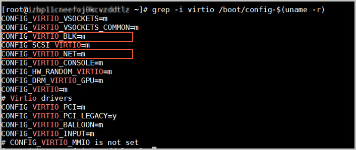

    1. To check whether the drivers are available on the Linux VM, run the following command:
      grep -i virtio /boot/config-$(uname -r)
      alivm1
      If the CONFIG_VIRTIO_BLK and CONFIG_VIRTIO_NET parameters display y, the virtio driver is already included, you do not need to make any further changes to the Linux VMs.
      If the parameters display m, then perform the following step.

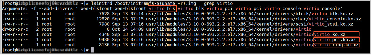

      1. Run the following command to verify that the virtio driver is compiled in the temporary root file system of initramfs or initrd.
        lsinitrd /boot/initramfs-$(uname -r).img | grep virtio
        Output:
        alivm2
        The output shows that the virtio driver is compiled in the temporary file system initramfs. If the virtio driver is unavailable in the initramfs, perform the following step to recover the temporary root file system initramfs before migration.
