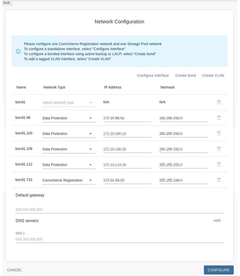

  4. Configure additional data protection VLAN interfaces (bonded) as follows:
    (Repeat this step to add all the VLANs available in your environment.)
    1. Click Create VLAN.
      The Create VLAN dialog box appears.
      Tagged vLAN and Bonding (18)
      1. From the Interface list, click bond1.
      2. In the VLAN ID box, enter the VLAN ID associated with the additional data protection VLAN network.
      3. Click CREATE.
      The new bond1 interface appears with the VLAN ID in the Node and Network Configuration page.
    2. From the Network Type list, select Data Protection.
    3. Add the IP Address and Netmask in the respective boxes.
    4. Repeat this step to configure ALL the VLANs available in your environment.
      Once completed your screen should be similar to the one shown in the following image: (The number of VLANs may vary depending on the number of VLANs available in your environment.)
      Tagged vLAN and Bonding (21)
