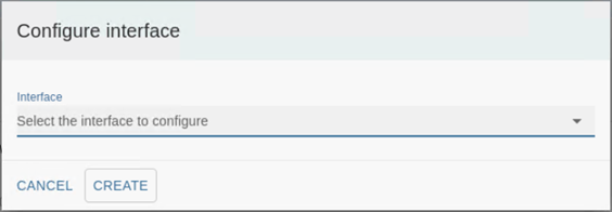

    1. Click Configure interface.
    3. Click CREATE.
    3. Click CREATE.
    4. From the Network Type list, select Storage Pool. This interface will be used exclusively for communication and replication between the HyperScale nodes.
  5. Configure the management interface as follows:
    2. From the Interfaces list, select one of the management interfaces. (For example, enpsf1 or enpsf2.)
    3. Click CREATE.
    4. From the Network Type list, select Management. This interface will be used for all management related communication, such as connecting to the CommServe server, accessing the DNS server, etc.

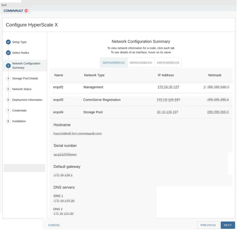

    • IP address and netmask for the management interface is accurate.
    Tagged vLAN and Bonding (25)
      The Setup Type page appears.
      Tagged vLAN and Bonding (26)
    Tagged vLAN and Bonding (27)
    3. Click NEXT.
      Tagged vLAN and Bonding (28)
    4. Click NEXT.

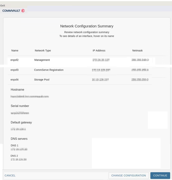

      Basic Deployment With 1 GbE Managment Network (9)
    Tagged vLAN and Bonding (32)
    5. Click NEXT.
