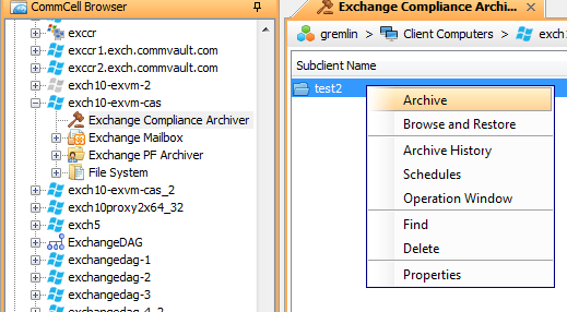

From the CommCell Console, navigate to <Client> | Exchange PF Archiver
Right-click the Subclient and click Archive

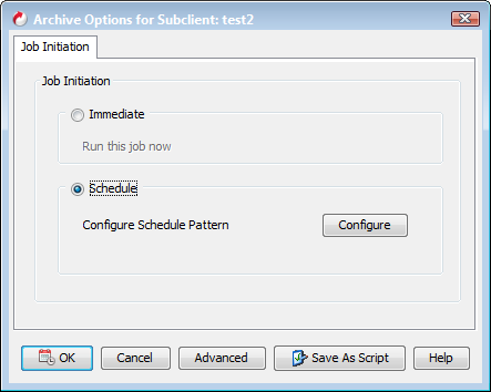

Click Schedule
Click Configure

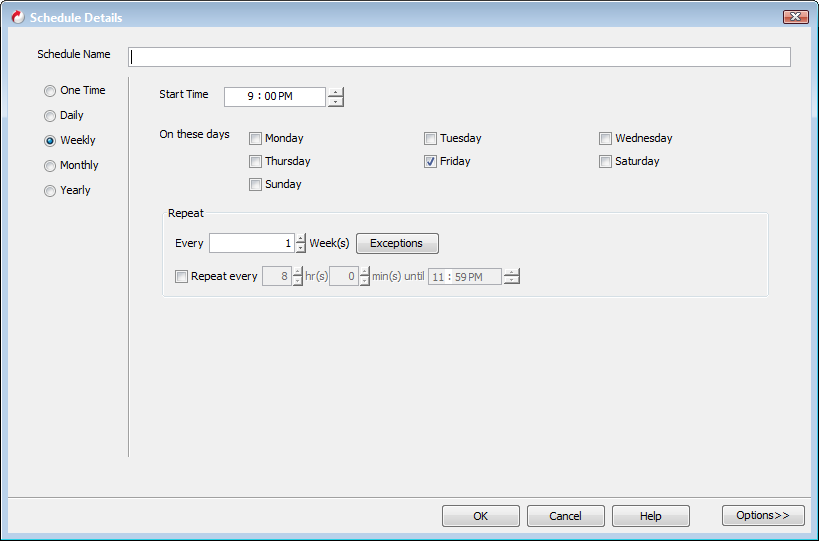

Select Schedule Options. For example:
Click Weekly
Check the days you want the run the archive job
Change the Start Time to 9:00 PM
Click OK to close the Schedule Details dialog box
Click OK to close the Archive Options dialog box
The archive job will execute as per the schedule

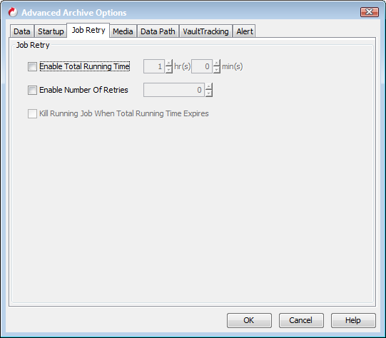

Click Advanced.
In the Advanced Archive Options dialog box, click the Job Retry tab.
Select Enable Total Running Time and specify the maximum elapsed time before a job can be restarted or killed.
Select Kill Running Jobs When Total Running Time Expires to kill the job after reaching the maximum elapsed time.
Select Enable Number Of Retries and specify the number of retries.
