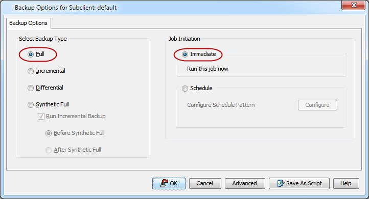

Full Backups
Full backups provide the most comprehensive protection of data. From the CommCell Browser, navigate to <Client> | File System | defaultBackupSet.
Right click the <Subclient> and click Backup.
Select Full as backup type and Immediate to run the job immediately.
You can track the progress of the job from the Job Controller or Event Viewer window. When the backup has completed, the Job Controller displays Completed.

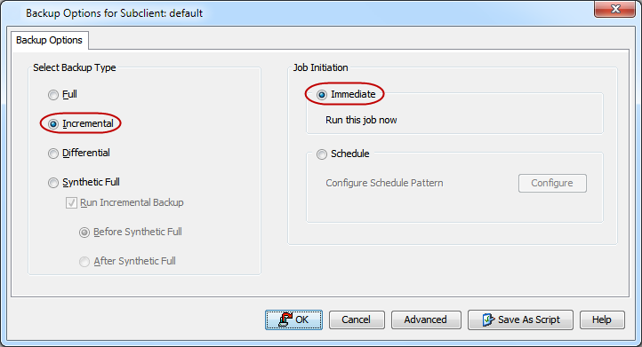

Follow the steps below to perform an incremental backup:
Select Incremental as backup type and Immediate to run the job immediately.
You can track the progress of the job from the Job Controller. When the backup has completed, the Job Controller displays Completed.

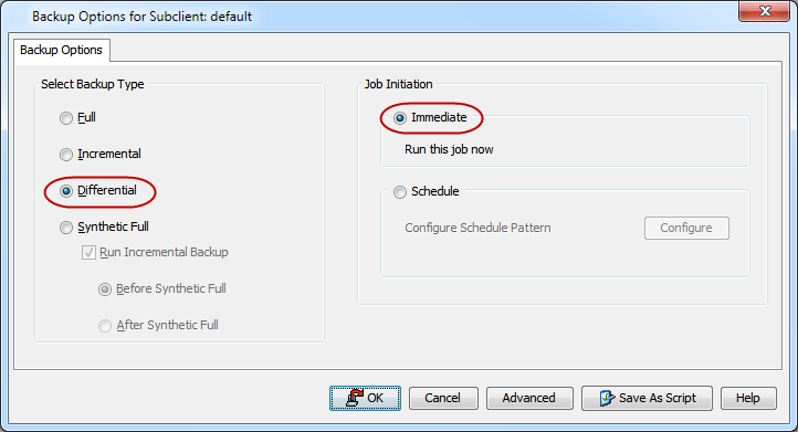

Follow the steps below to perform a differential backup:
Select Differential as a backup type and Immediate to run the job immediately.
You can track the progress of the backup job from the Job Controller. When the backup has completed, the Job Controller displays Completed.

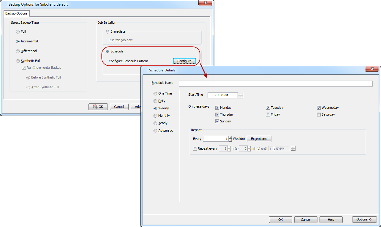

Scheduling a Backup
From the CommCell Console, navigate to Client Computers | <Client> | File System | defaultBackupSet.
Right click the default <Subclient> and click Backup.
Click Schedule.
Click Configure.
Select the appropriate scheduling options. For example:
Click Weekly.
Check the days you want the run the restore job.
Change the Start Time to 9:00 PM
Click OK to close the Schedule Details dialog
Click OK to close the Backup Options dialog

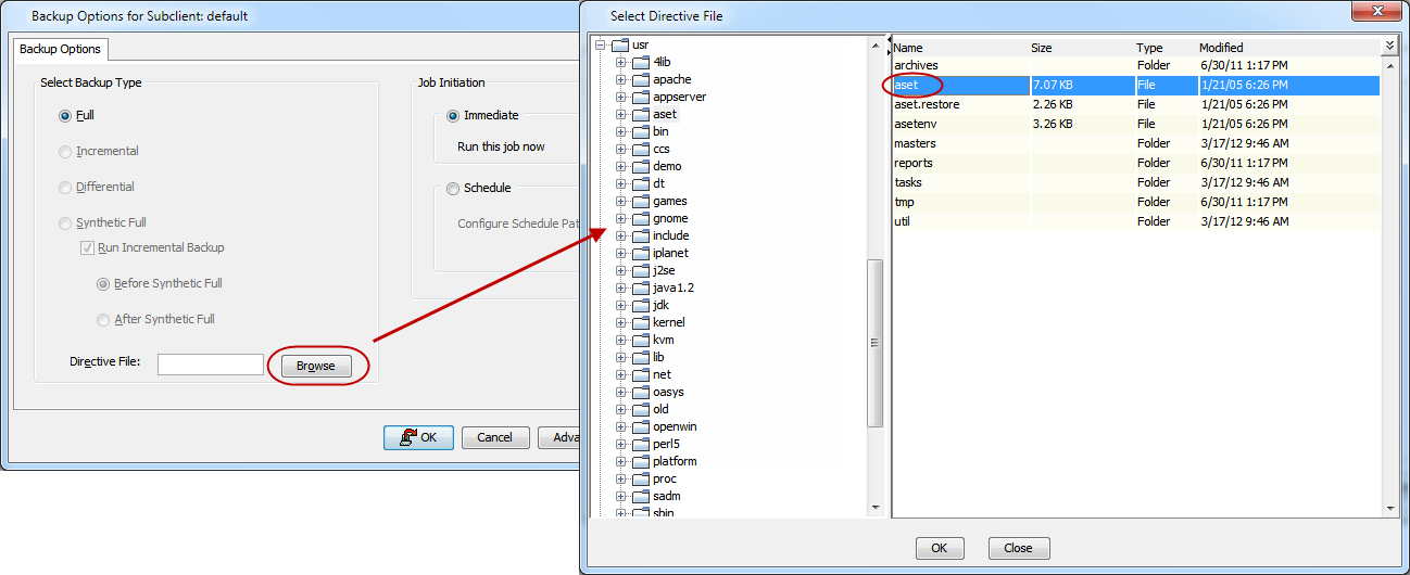

Performing an On-Demand Backup
From the CommCell Browser, navigate to <Client> | File System |<On-Demand Backup Set>.
Click Browse.
Navigate to the Directive file or Content file that you want to use.
