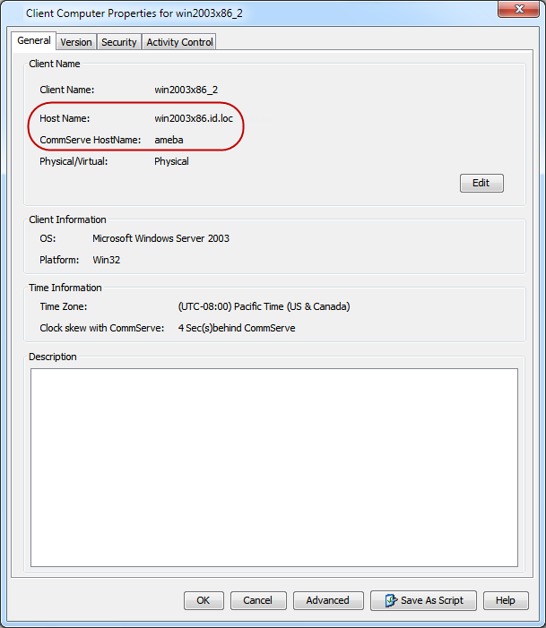

From the CommCell Browser, right click the CommServe and click Properties. Check the CommCell Host Name.
From the CommCell Browser, right click the Client computer and click Properties. Check the Host Name and CommServe Host Name.

Now to get the information for the MediaAgent (MA) or the Client (CL), locate the MA or CL in the CommCell Browser window, right click, and then click Properties. On the General tab, the host name and the CommServe host name will be displayed.
Now once the MediaAgent (MA) and/ or Client (CL) CommCell information is confirmed, go to the MA and/or CL and review the registry entries for the Name.
