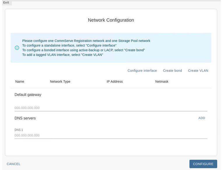

Log on to one of the nodes using the system console as described in Setting up a Static IP For IPMI. (Do not use PuTTy / SSH to setup the nodes.)

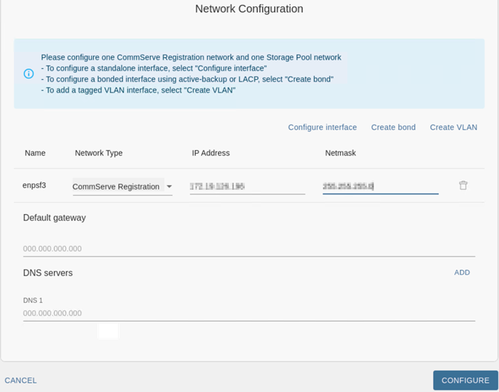

Launch the network configuration interface using the following command:
# hsxsetupThe Network Configuration page appears.

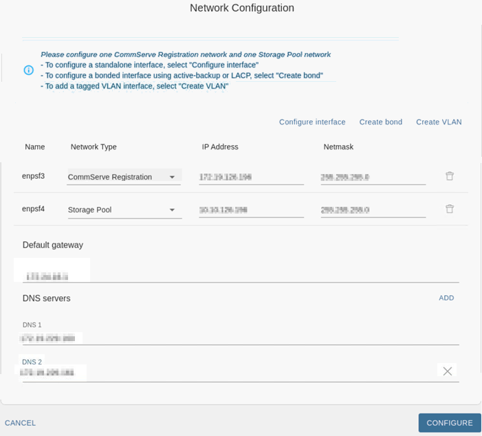

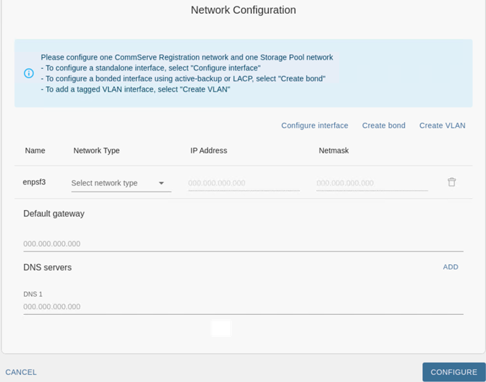

Configure the data protection interface as follows:

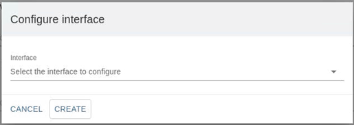

Click Configure interface.
From the Interfaces list, select one of the data protection interfaces. (For example, enpsf3 or enpsf5.)
Click CREATE.
From the Network Type list, select CommServe Registration
Add the IP Address and Netmask in the respective boxes.
Configure the storage pool interface as follows:
From the Interfaces list, select one of the storage pool interfaces. (For example, enpsf4 or enpsf6.)
Click CREATE.
The selected interface appears in the Node and Network Configuration page.
From the Network Type list, select Storage Pool. This interface will be used exclusively for communication and replication between the HyperScale nodes.
Configure the DNS server(s) as follows:
In the Default Gateway box, add the IP address associated with the default gateway.
In the DNS Servers box, add the IP address associated with the DNS Server.
Click CONFIGURE

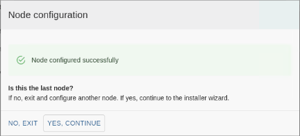

Verify the network configuration and then click CONTINUE.
IP address and netmask for the data protection interface accurate.
IP address and netmask for the storage pool interface is accurate.
Hostname and serial number associated with the node is accurate.
Default gateway and DNS servers are accurately configured.
Click one of the following:
Click NO, EXIT to configure another node in the storage pool.
Click YES, CONTINUE if this is the last node in the storage pool.

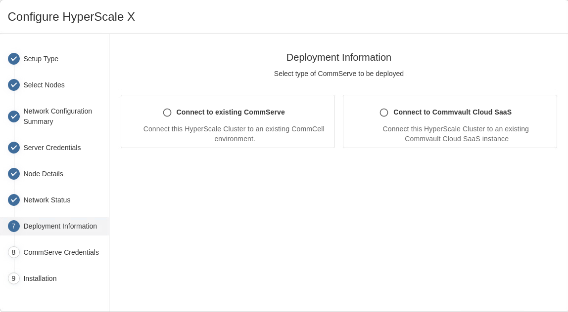

The steps to connect to the CommServe differ based on your environment.

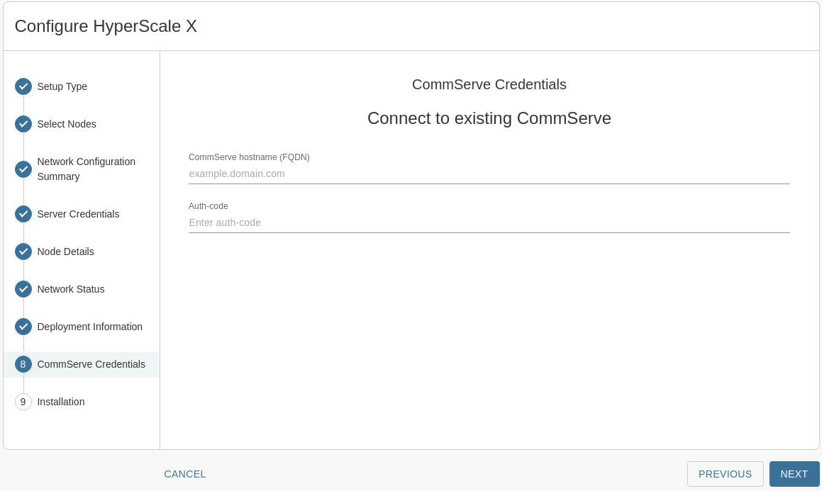

In a Software environment, complete the following steps:
Click Connect to existing CommServe, and then click NEXT.
The CommServe Credentials page appears.
In the CommServe hostname (FQDN) box, enter a fully qualified host name of the existing CommServe server that you are connecting to.
In the Auth-code box, enter the authorization code to connect to the CommServe server.
Click NEXT.

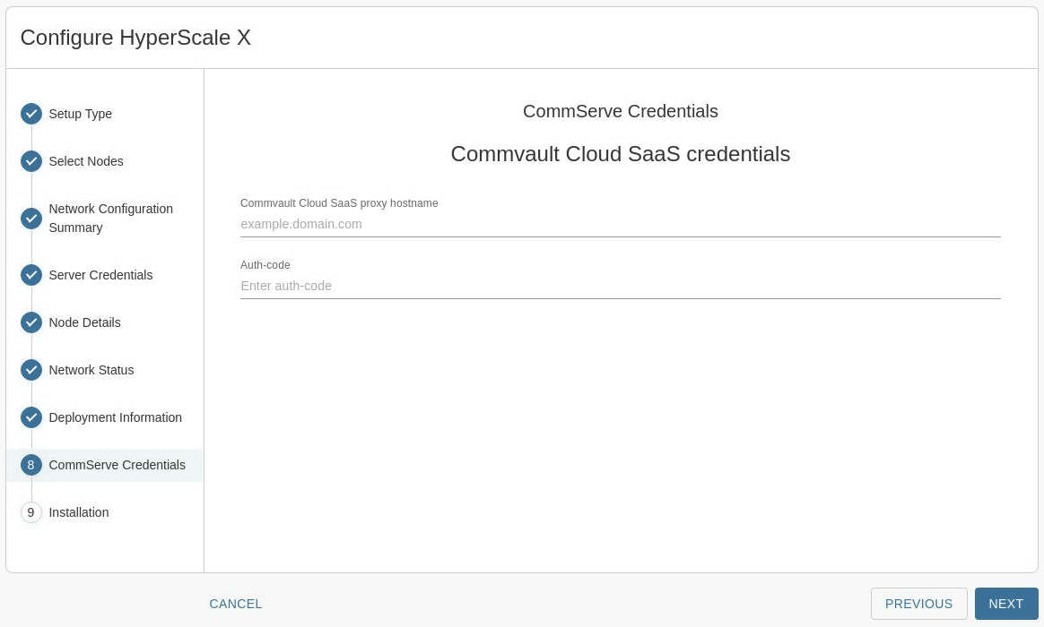

In a SaaS environment, complete the following steps:
Click Connect to Commvault Cloud SaaS, and then click NEXT.
In the Commvault Cloud SaaS proxy hostname box, enter the fully qualified host name of the existing backup gateway that you are connecting to.
Click NEXT.
