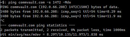

Example 1:
In the following example, using a Layer 2 MTU size of 1500, there are no discarded packets.

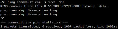

Example 2:
In the following example, using a Layer 2 MTU size of 9000, there are discarded packets.
