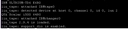

In the dmesg log file, you can verify if the lin_tape device driver is attached at the operating system level. After the Linux tape device driver is attached, it is renamed as follows:
For IBM tape devices, the lin_tape is renamed to IBMtape(n).
For the arm, the lin_tape is renamed to IBMchanger(n)
where (n) is the number of the device.
For example, if you have three tape device drivers, the lin_tape attachments are IBMtape0, IBMtape1, and IBMtape2.
The following excerpt of the dmesg log file displays the lin_tape device driver binding to one arm and one drive in a library.
