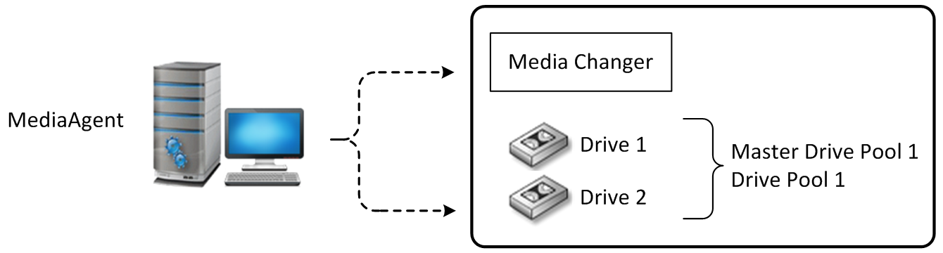

Direct-Attached Libraries with the Same Drive Types
A direct-attached library is physically attached to the MediaAgent that controls the library. The following illustration represents a direct attached library with the same drive type.

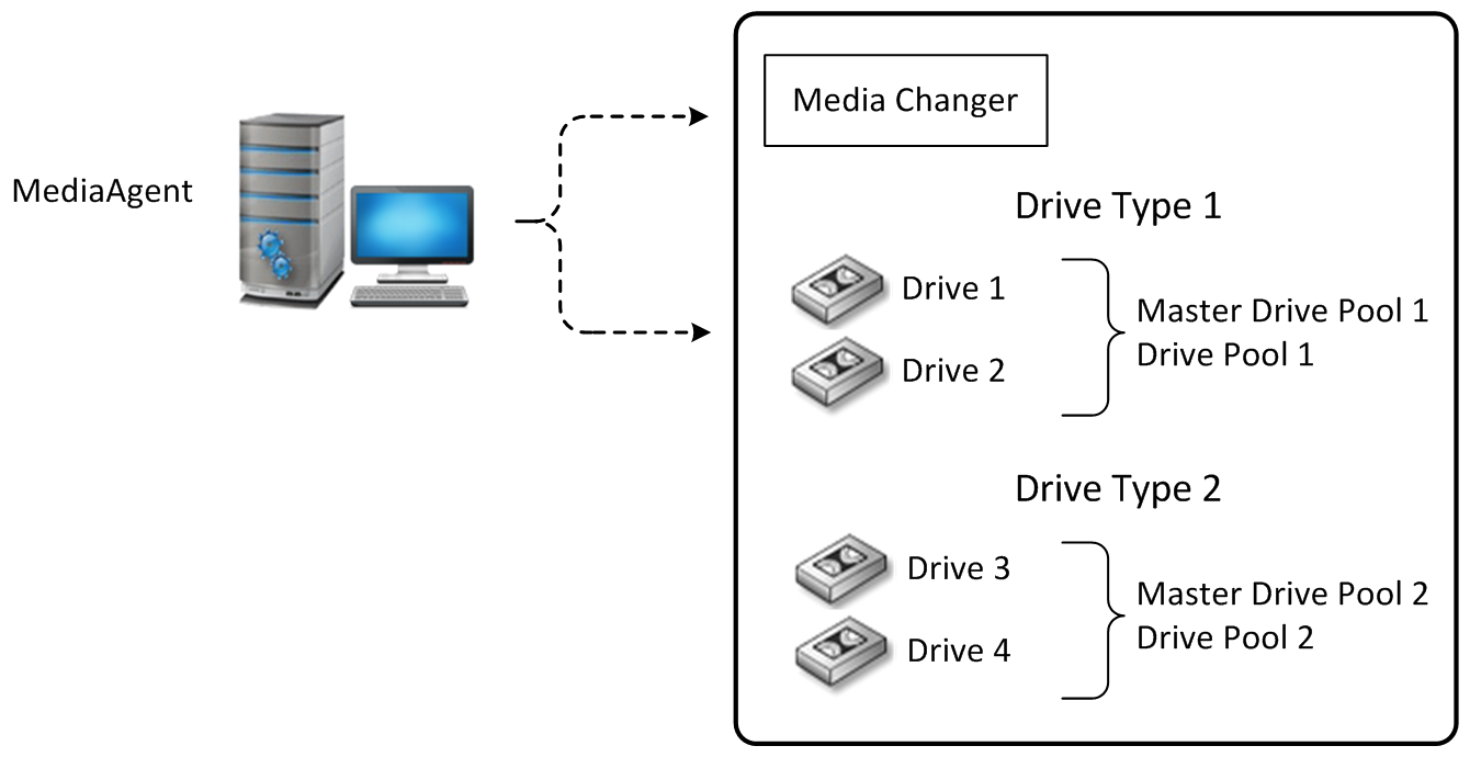

Direct-Attached Libraries with Mixed Drive Types
Some libraries might have different or mixed drive types. Such drives might or might not use the same type of media. The following illustration represents a direct attached library configuration with mixed drive type.
