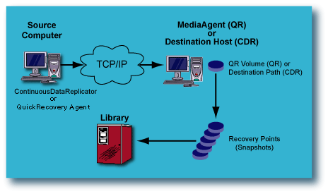

Recovery Point is set of snapshots of the data to preserve a point-in-time on the Destination. This not only affords an extra measure of protection for your data, it also expands the number of options you have when recovering your data.
For any supported configurations snapshot-based Recovery Points can be created and backed up. In addition, Recovery Points can be mounted, and for Windows can also be shared, to make it available to users on the network.
A Recovery Point is created at the Replication Set level. It will consist of a snapshot of every destination volume used by all the Replication Pairs that comprise the Replication Set.

The following image shows data flows during creation of Recovery Points and backup of Recovery Points:
