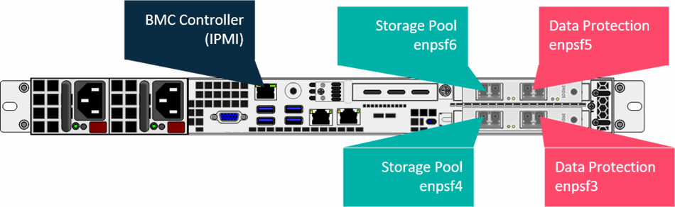

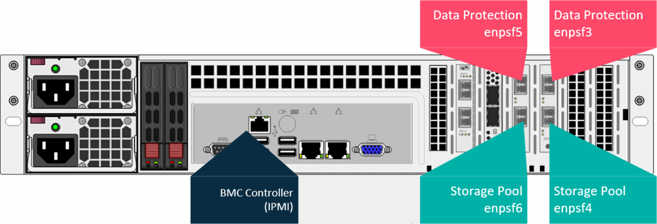

Cabling and Cable Connections
Connect the 2 - 10 GbE data protection port from each node to the data protection network.
All data management tasks including backups and restores, are established through the 2 - 10GbE data protection ports.
Connect 2- 10 GbE storage pool port from each node to the private storage pool network.
All storage related tasks, including all cluster connectivity for the storage pool network, will be through these 2- 10 GbE storage pool ports.
Connect the 1 GbE IPMI port (BMC Controller) from each node to the IPMI or management or utility network for lights out access.
HS4300 Connections
HS2300 Connections
Supported Network Cables

1x 1 GbE network cable for the iRMC port
4x 10 GbE network cables for the bonded data protection and storage pool ports
3x 1 GbE network cables for the iRMC ports
12x 10 GbE network cables for the bonded data protection and storage pool ports
