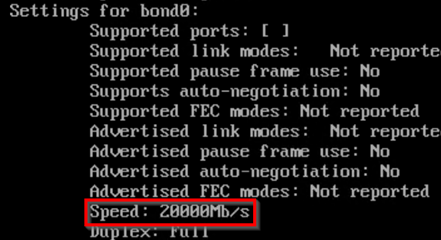

From the output, verify that the listed speed for the bonded interface is double the speed of the child interface.
For example, when bonding 2 x 10 Gigabit interfaces the speed should be 20000Mb/s (as shown in the following sample image:
Verifying LACP Bonding Configuration (1)

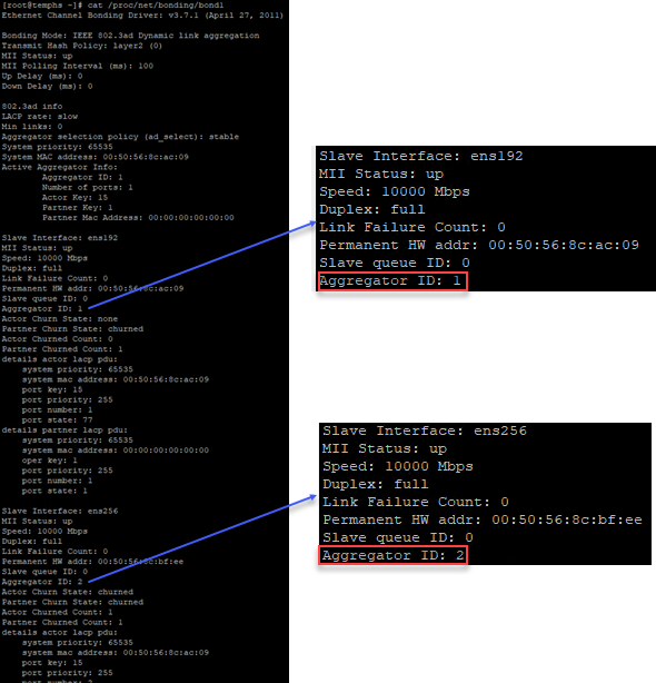

    The LACP protocol requires identical configurations on the switch. If these configurations do not match or if the appliance ports were improperly cabled, it will only allow one of the interfaces to become part of the bond. The simplest way to diagnose this issue is by using the following command:
    cat /proc/net/bonding/<bond interface>
    For example:
    cat /proc/net/bonding/bond1
    You should see an output similar to the one shown in the following image:
    Verifying LACP Bonding Configuration (2)
    The key detail is the Aggregator ID of each child interface. If this does not match between the two child interfaces, it indicates a cabling or configuration issue that your Network Administrator has to diagnose and resolve. It cannot be resolved from the appliance.
