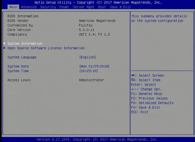

  2. Press <F2> during the boot sequence to start the Setup Utility.
    Setting up the Integrated Remote Management Console (iRMC) (1)

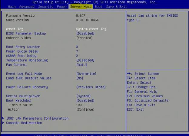

  3. Navigate to the Server Mgmt tab.
    Setting up the Integrated Remote Management Console (iRMC) (2)

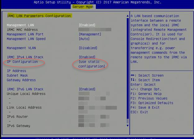

  4. Navigate to the iRMC LAN Parameter Configuration option.
  5. Press <Enter> to select the option and then navigate to the IP Configuration option.
  6. Change the option to [use static configuration].
    Setting up the Integrated Remote Management Console (iRMC) (3)
  7. Enter values for the IP Address, Subnet Mask, and Gateway Address for the selected node. Use the data collected in the Pre-Installation Checklist to add the information.

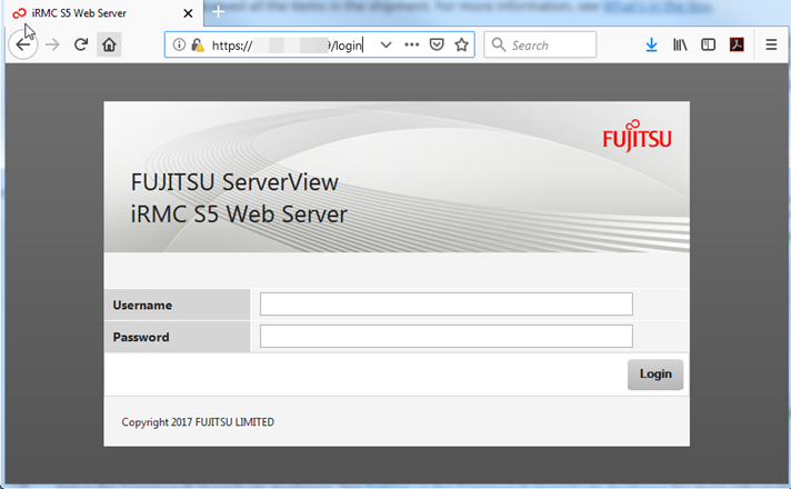

  9. Verify that the iRMC is accessible using the static IP address as follows:
    1. Open a web browser from a remote workstation and enter the static IP of the iRMC.
      The login screen is displayed.
      Setting up a Static IP For the Integrated Remote Management Console (iRMC) (1)
    2. Type in the credentials for the default administrator account as follows:
      Username: admin
      Password: admin
      Click Login.

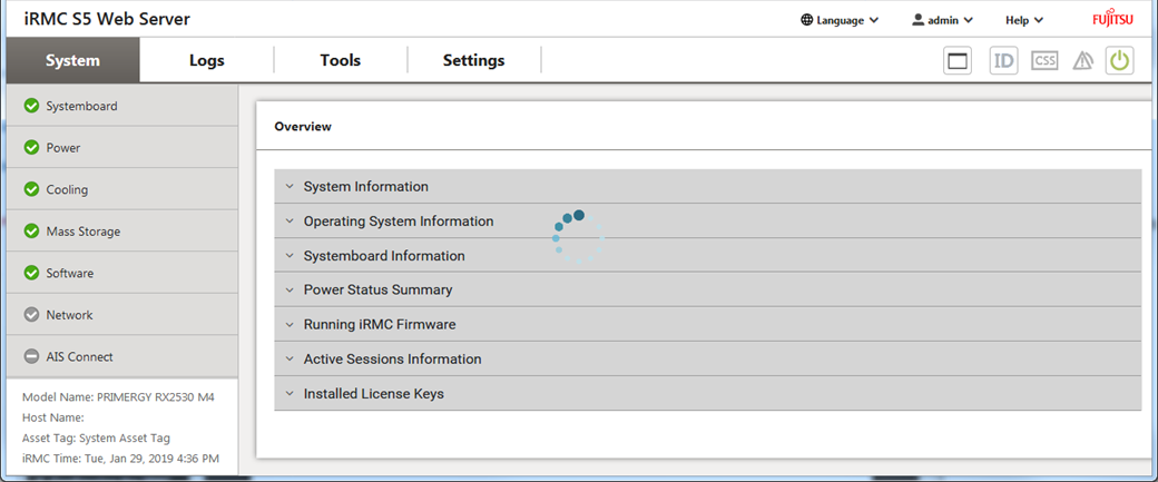

      The iRMC Web Server interface is displayed.

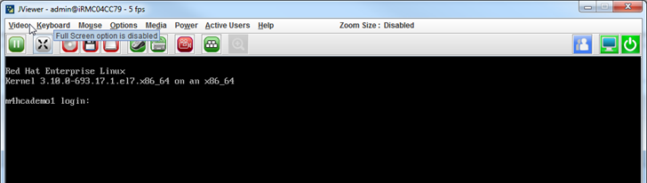

    3. Login using the following default credentials:
      Login: root
      Password: cvadmin
      This password can be changed during setup.

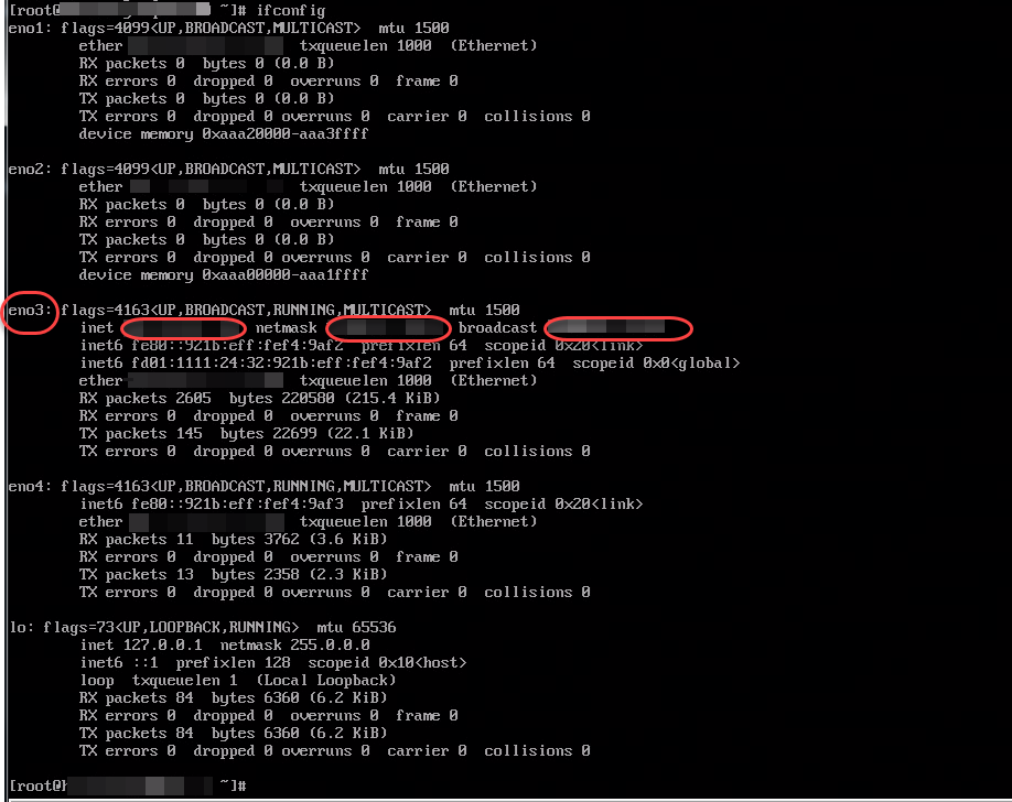

  11. Run the ifconfig command from each node and note down the IP address and the corresponding network interfaces.
    A sample output of the command is shown below:
    Setting up the HyperScale 1.5 Appliance (1)
    If DHCP is not available the IP addresses for the interfaces will not be displayed. You must assign static IP addresses for the interfaces. For more information, see Assigning a Static IP If DHCP is Not Enabled.
