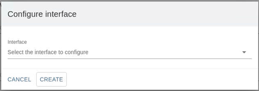

    1. Click Configure interface.
      Tagged VLAN (2)
    3. Click CREATE.

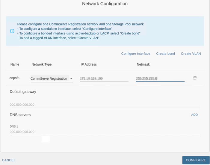

    4. From the Network Type list, select CommServe Registration

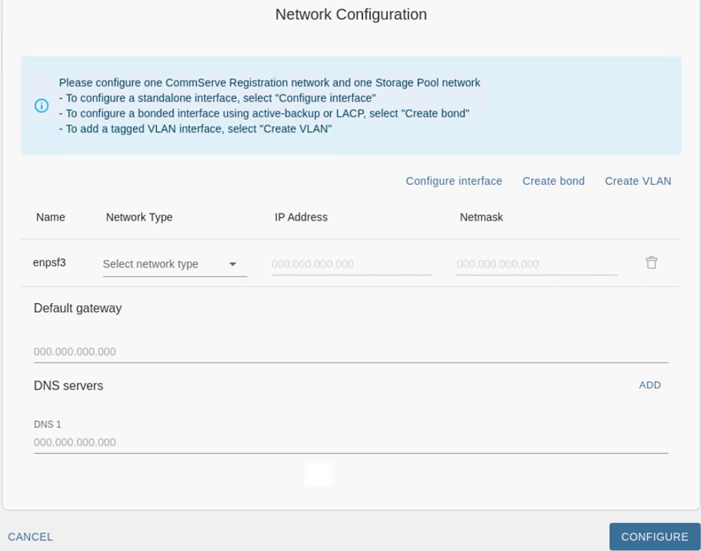

      Tagged VLAN (2)
    3. Click CREATE.
      The selected interface appears in the Node and Network Configuration page.

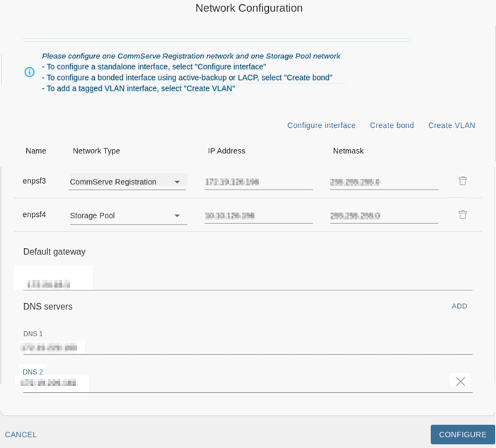

  5. Configure the DNS server(s) as follows:
    Basic Deployment (1)
  6. Click CONFIGURE
  7. Verify the network configuration and then click CONTINUE.
