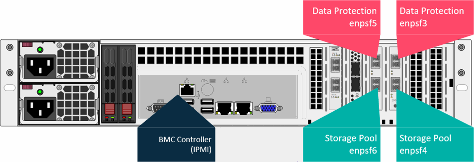

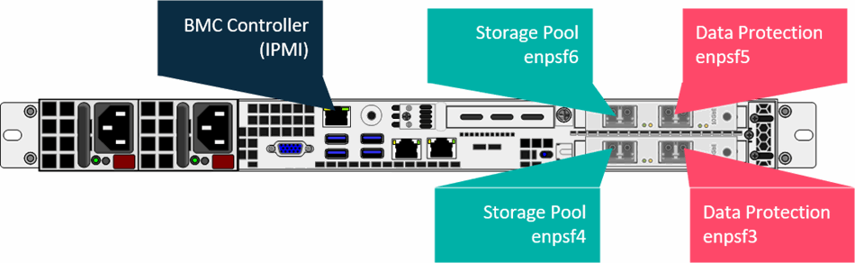

Cabling and Cable Connections
  1. Connect 2 - 10 GbE data protection ports from each node to the data protection network.
    All data management tasks including backups and restores, are established through these 2 - 10 GbE data protection ports.
  2. Connect 2- 10 GbE storage pool port from each node to the private storage pool network.
    All storage related tasks, including all cluster connectivity for the storage pool network, will be through these 2- 10 GbE storage pool ports.
  3. Connect the 1 GbE IPMI port (BMC Controller) from each node to the IPMI or management or utility network for lights out access.
HS4300 Connections
Bonded Topology (2)
HS2300 Connections
Bonded Topology (3)
