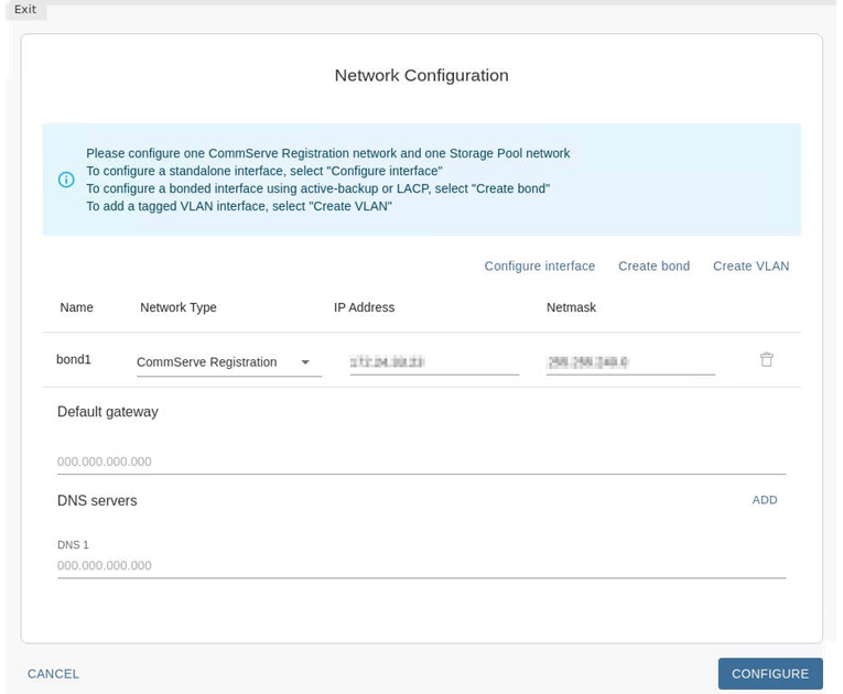

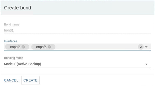

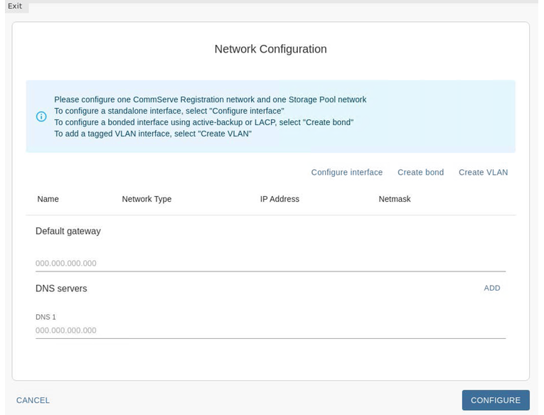

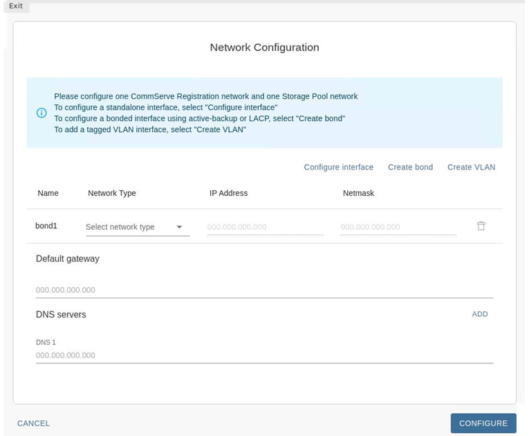

  3. Create a data protection interface bond as follows:
    1. Click Create bond.
      Tagged vLAN and Bonding (30)
    2. From the Interfaces list, select the data protection interfaces. (enpsf3 or enpsf5)
    3. From Bonding mode list, select either active-backup (Mode 1) or LACP (Mode 4).
    4. Click CREATE.
      Tagged vLAN and Bonding (17)

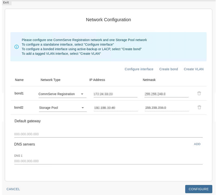

    5. From the Network Type list, select CommServe Registration
    6. Add the IP Address and Netmask in the respective boxes.
      LACP Bonding (1)

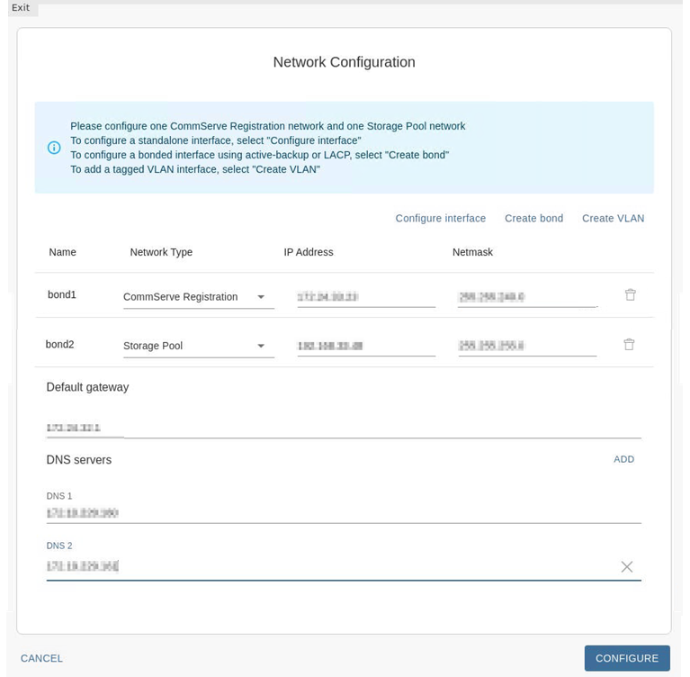

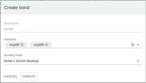

  4. Configure the storage pool interface (bonded) as follows:
      Tagged vLAN and Bonding (31)
    2. From the Interfaces list, select the 2 interfaces that will form the storage pool bond. (For example, enpsf4 and enpsf6 .)
    4. Click CREATE.
    5. From the Network Type list, select Storage Pool. This interface will be be used exclusively for communication and replication between the HyperScale nodes.
      LACP Bonding (2)
  5. Configure the DNS server(s) as follows:
      LACP Bonding (3)
    3. Click CONFIGURE.

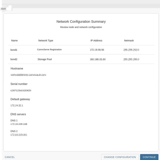

  6. Verify the network configuration and then click CONTINUE.

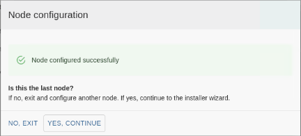

  7. Click one of the following:
      Repeat the steps (step 1 through 6) from another node.

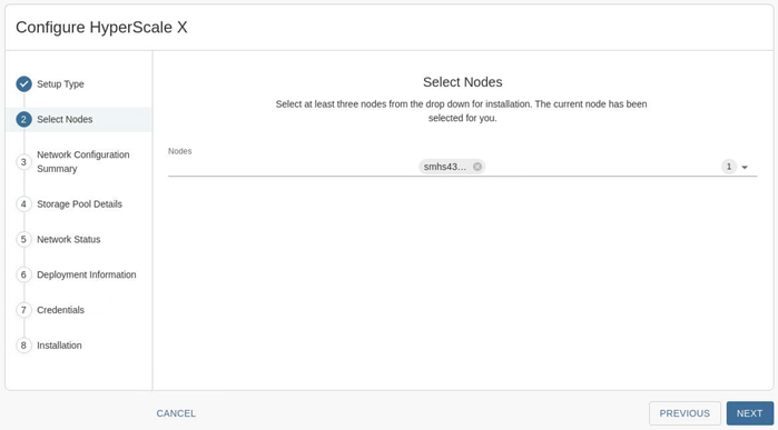

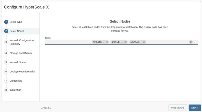

  9. Select the nodes as follows:
      You can select up to 12 nodes at a time for the initial deployment. Nodes are listed by serial number. If one or more nodes are missing from the list, there is likely a cabling or network configuration issue. To troubleshoot, see Troubleshooting Network Configuration Errors.
    3. Click NEXT.

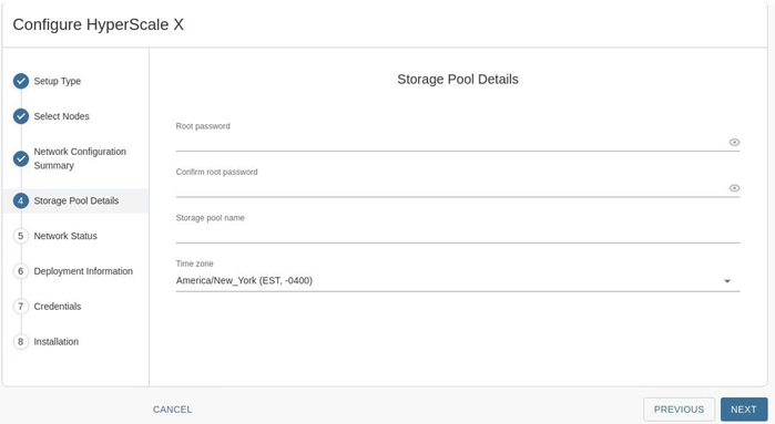

  11. Add the following information:
      Note down the storage pool name. This will be helpful to identify the storage pool in the Metallic console.
    5. Click NEXT.

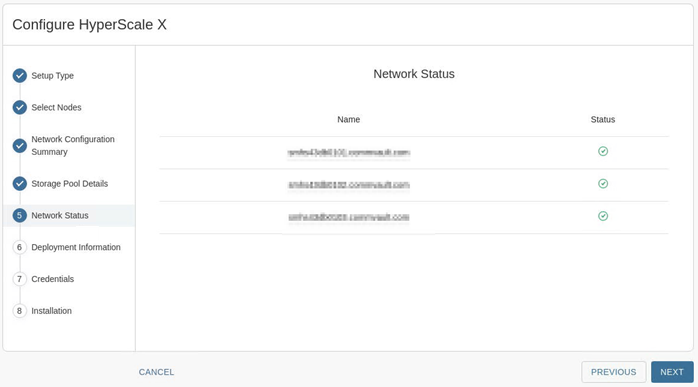

  12. Check the status to ensure that all the nodes have a green status to indicate that the network settings is validated and accurate. Click NEXT.

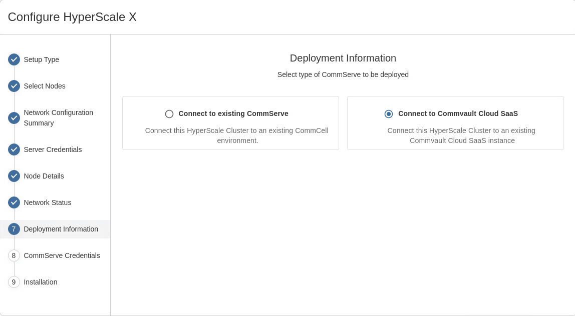

  13. Click Connect to Commvault Cloud SaaS and then click NEXT.
    The Commvault Cloud SaaS Credentials page appears.

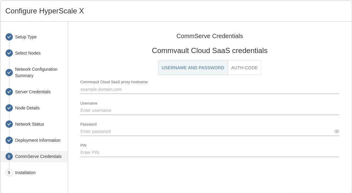

  14. Enter the following information:
    1. In the Commvault Cloud SaaS proxy hostname (FQDN) box, enter the fully qualified host name of the existing backup gateway that you are connecting to.
      TCP Ports 8400 and 443 must be open from the nodes to the Server Gateway for the registration to work.
    2. In the Username and Password box, enter the credentials that must be used to access the Server Gateway.
    3. In the PIN box, enter the PIN generated by the authenticator tool that you use for multi-factor authentication.
    4. Click NEXT.
