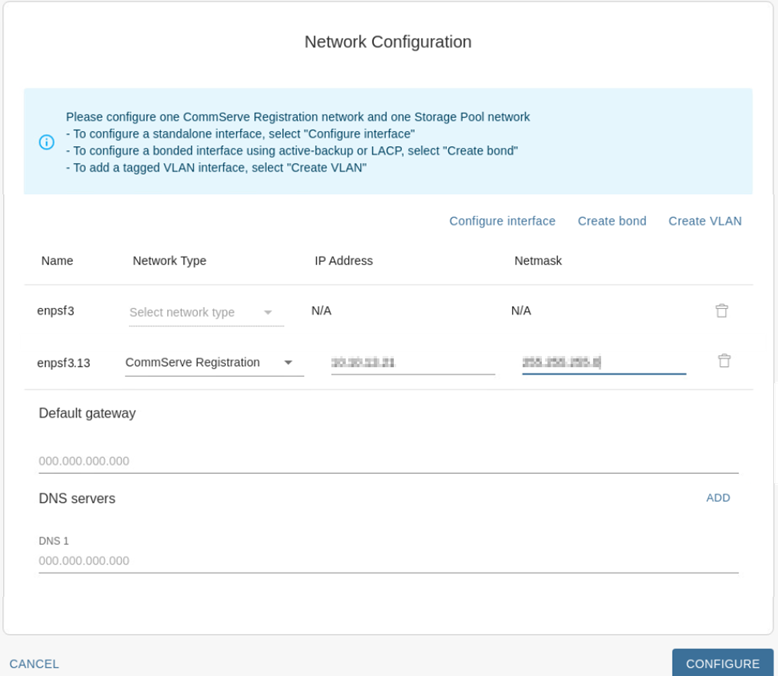

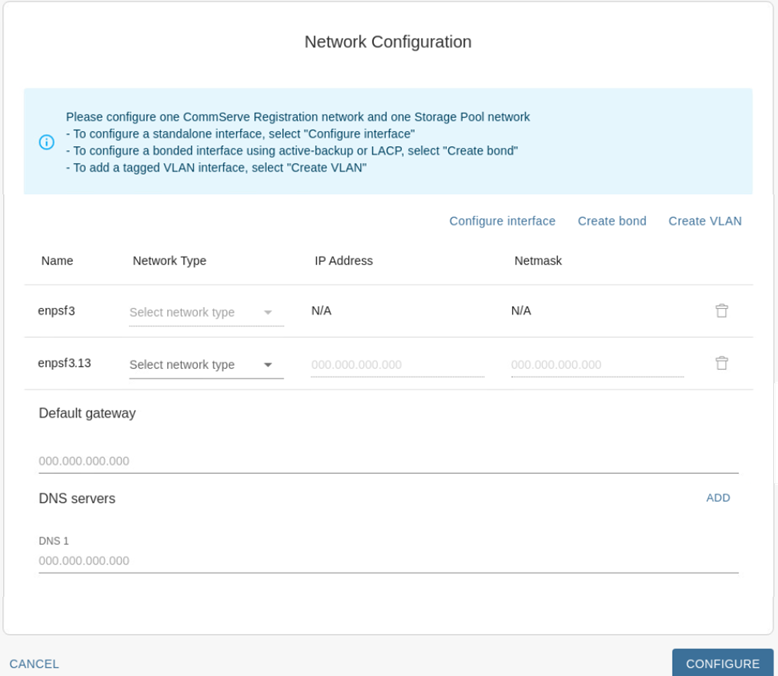

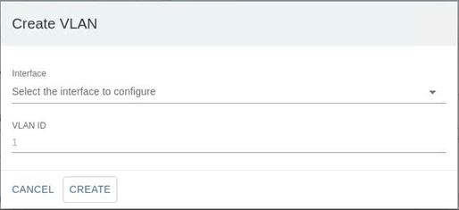

  3. Configure the routable data protection VLAN interface as follows:
    1. Click Create VLAN.
      The Create VLAN dialog box appears.
      Tagged VLAN (8)
    3. In the VLAN ID box, enter the VLAN ID associated with the routable VLAN network and then click CREATE.
      The interface appears with the VLAN ID in the Network Configuration page. (The VLAN ID will be different, depending on the VLAN ID in your environment.)
      embd_TaggedVLAN1 (5)
      This network will perform the same role as the data protection network and will also be used to register the node to the Server Gateway.
      embd_TaggedVLAN1 (6)

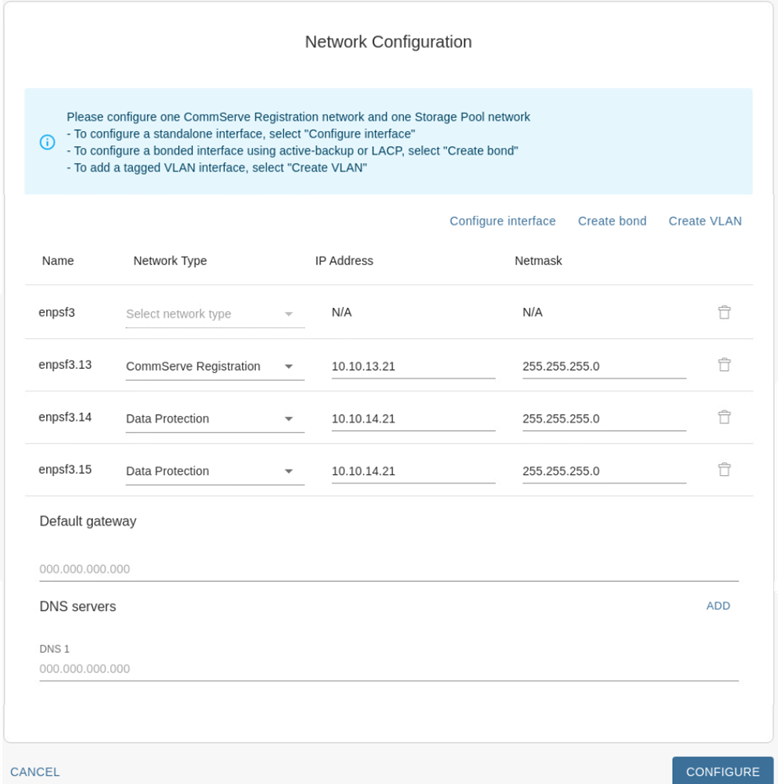

  4. Configure additional data protection VLAN interfaces as follows:
    (Repeat this step to add all the VLANs available in your environment.)
      Tagged VLAN (8)
    3. In the VLAN ID box, enter the VLAN ID associated with the VLAN network and then click CREATE.
    4. From the Network Type list, select Data Protection.
    6. Repeat this step to configure ALL the VLANs available in your environment.
      Once completed your screen should be similar to the one shown in the following image: (The VLAN IDs and the number of VLANs will be different, depending on the VLAN configuration in your environment.)

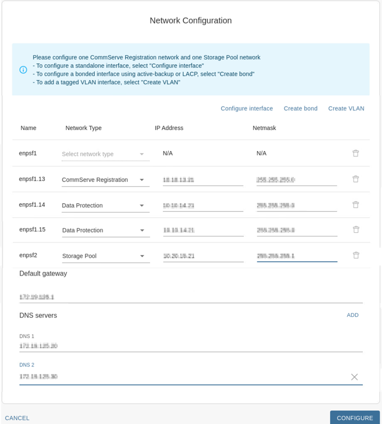

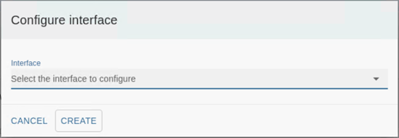

  5. embd_TaggedVLAN1 (7)Configure the storage pool interface as follows:
    1. Click Configure interface.
    3. Click CREATE.
      embd_TaggedVLAN2 (2)
      Tagged VLAN (9)
    3. Click CONFIGURE.
      Tagged VLAN (15)

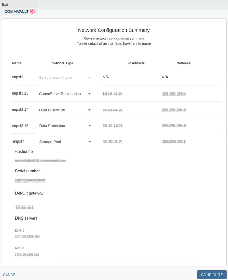

  7. Verify the network configuration and then click CONTINUE.
    • All the VLANs are included.
    • IP address and Netmask for the VLANs are accurate.
    • IP address and Netmask for the storage pool is accurate.
      Tagged VLAN (7)
