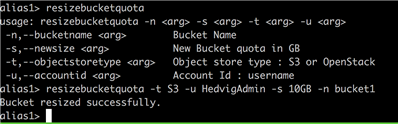

  • If a bucket is created with a predetermined quota size, then the size of the bucket is reflected immediately at creation in the tenant quota current capacity. Object creation in a bucket is allowed only until this quota threshold is reached. The bucket quota can be resized using the resizebucketquota command.

    Important
    The resizebucketquota command can only increase bucket quota, that is, it cannot shrink it.
