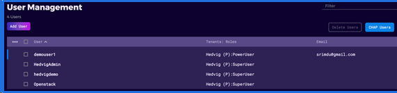

    • If you are logged in with Hedvig SuperUser privileges, select the User icon at the top right. In the pulldown menu, select User Administration -> User Management.
      Generating Security Tokens using the Hedvig WebUI (1)
      The list of users in the cluster is displayed, as shown in the User Management dialog.
      Generating Security Tokens using the Hedvig WebUI (2)
      Select the user for which you want to send the security token, which will open the user’s Edit Profile dialog.

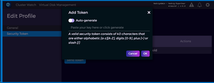

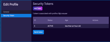

  4. In the Security Token dialog, any tokens affiliated with this user are displayed. To add a token, select Add Token and choose whether you want to Auto-generate the token or enter it yourself.
    Generating Security Tokens using the Hedvig WebUI (7)

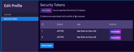

  5. The new token is then displayed. Notice that you can have only two tokens at a time per user.
    Generating Security Tokens using the Hedvig WebUI (8)

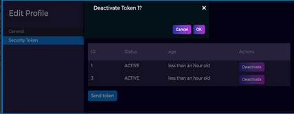

  6. To deactivate a token, select Deactivate.
    Generating Security Tokens using the Hedvig WebUI (9)

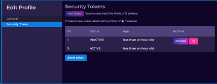

  7. The token is then marked as INACTIVE.
    Generating Security Tokens using the Hedvig WebUI (10)

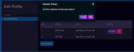

  8. To remove a token completely, select the trash can icon.
    Generating Security Tokens using the Hedvig WebUI (11)

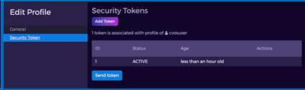

  9. The token is then completely removed.
    Generating Security Tokens using the Hedvig WebUI (12)
