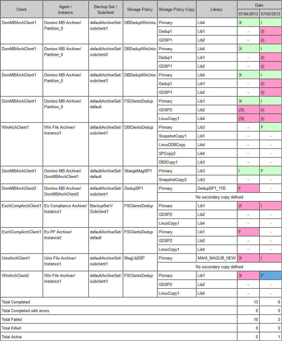

Calendar View
The Calendar Archive/Compliance Archive Job Summary Report displays information about the archive jobs on each selected client for each date in the specified time range.
archive_job_summary_calendar
Column
Client
Name of the client computer.
Agent/Instance
Agent type and instance name on which archive jobs ran.
Backup Set/Subclient
Name of the backup set and subclient on which archive jobs ran.
Storage Policy
Name of the storage policy assigned to the subclient on which archive jobs ran.
Storage Policy Copy
Name of the storage policy copy assigned to the subclient on which archive jobs ran.
Library
Name of the library on which the archive data is stored.
Date
Date range that was entered in the report settings.
Total Completed
Number of completed archive jobs.
Total Completed with Errors
Number of archive jobs that completed with one or more errors.
Total Failed
Number of archive jobs that failed to complete.
Total Killed
Number of archive jobs that were killed.
Total Active
Number of archive jobs that were active at the time the report ran.
Setting
To display the calendar view of the Archive/Compliance Archive Job Summary Report, on the General tab, select Calendar.

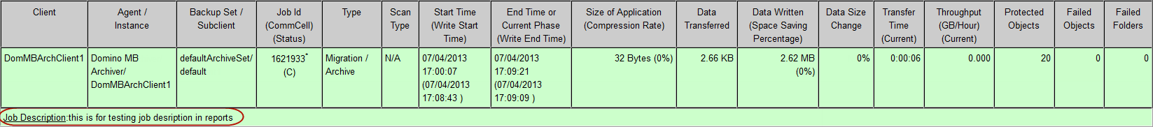

Job Description
When you configure the Jobs with Description option, only jobs that contain the specified description appear in the report. The Job Description section displays the description that the initiating user entered for the job.
archive_job_summary_description
Setting
To display only jobs that contain a particular description, on the General tab, select Jobs with Description, and then enter a description in the box.

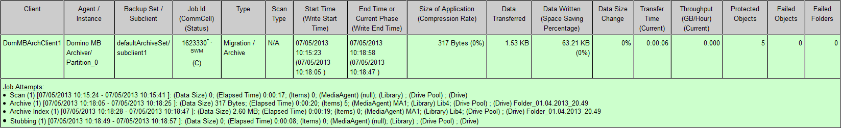

Job Attempts
When you select the Job Attempts option, each phase of the archive job is listed, along with details, such as the amount of time that elapsed for that phase of the job.
archive_job_summary_job_attempts
Setting
To display the details for each phase of the archive job, on the Selection tab, click Job Attempts.

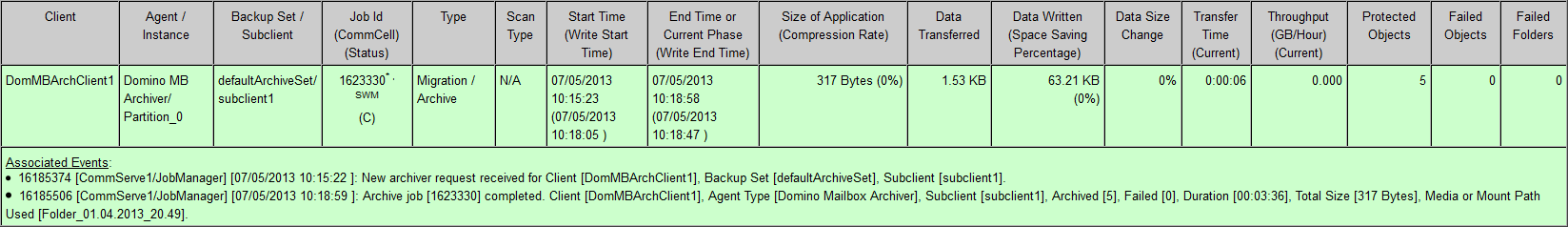

Associated Events
When you select the Associated Events option, any events that are logged as a result of the archive job appear in a list under each job.
archive_job_summary_events
Setting
To display the events that are associated with each archive job, on the Selection tab, click Associated Events.

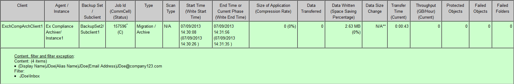

Content, Filter, and Filter Exception
When you select the Subclient Content and Filters option, any content that is purposely excluded from the archive job is listed under each job.
archive_job_summary_content_filters
Setting
To display the content that is excluded from jobs, on the Selection tab, click Subclient Content and Filters.

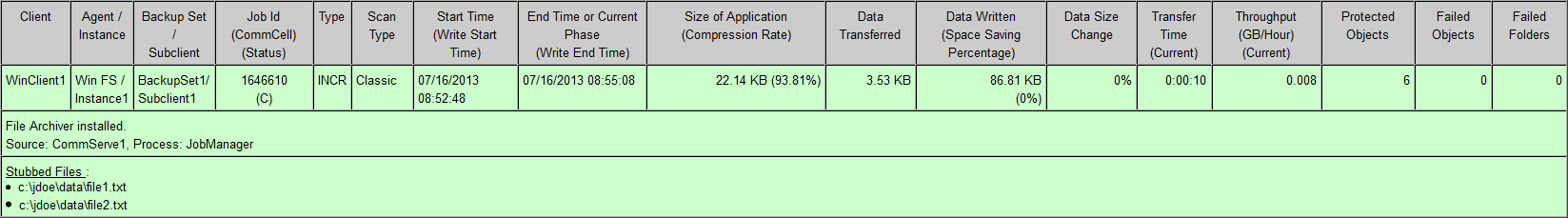

Stubbed Files
When you select the Stubbed Files option, any files that were stubbed during the archive job are listed under the job ID.
archive_job_summary_stubbed_files
Setting
To display the list of stubbed files, on the Selection tab, click Stubbed Files.

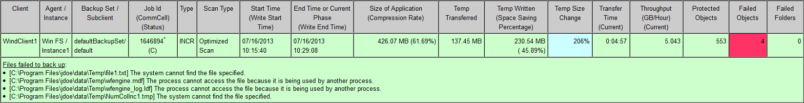

Files Failed to Back Up
When you select the Failed Objects option, any files that failed to be archived are listed under the job ID.
archive_job_summary_failed_files
Settings
To display the list of failed files, on the Selection tab, click Failed Objects, and then specify the maximum number of objects to include in the list.

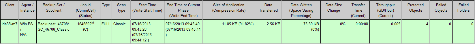

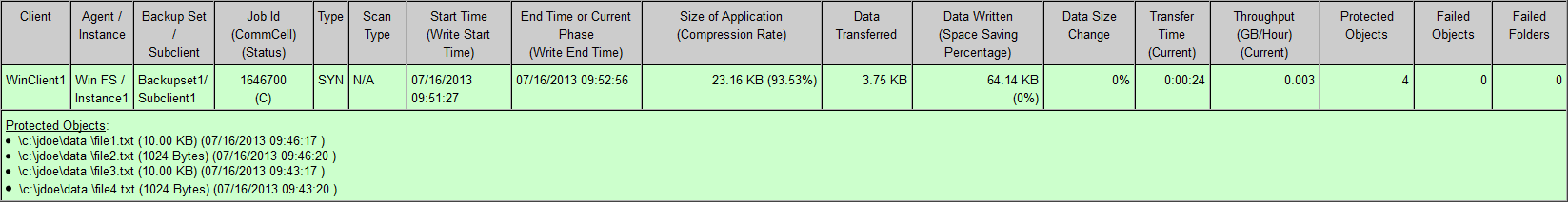

Protected Objects
When you select the Protected Objects option, all files that were included in the archive job are listed under the job ID.
archive_job_summary_protected_objects
Settings
To display a list of all archived files for each job, on the Selection tab, click Protected Objects, and then specify the maximum number of objects to include in the list.

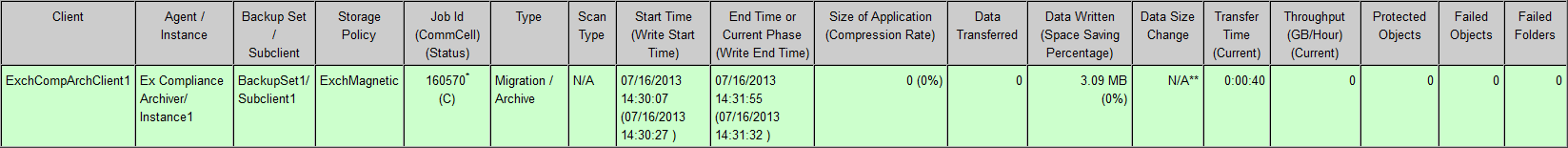

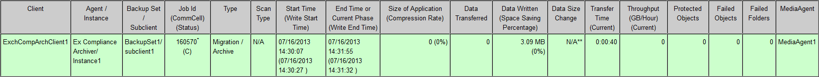

Associated Media Column
When you select the Associated Media option, the media that was used for the archiving job appears in the Associated Media column.
archive_job_summary_associated_media
Settings
To display the Associated Media column, on the Selection tab, click Associated Media.

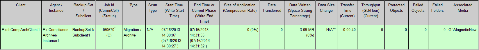

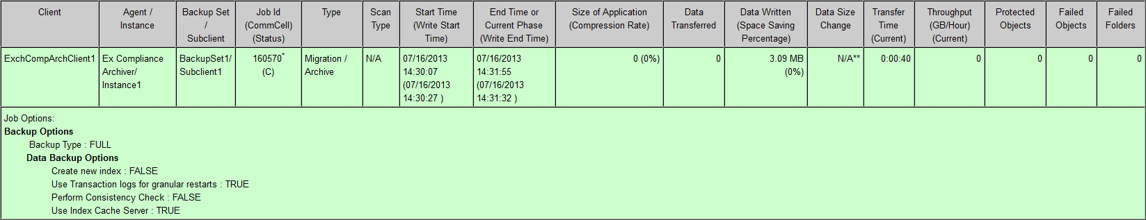

Job Options
When you select Job Options, all of the settings that are configured for a job are listed under the job ID.
archive_job_summary_job_options
Setting
To display the settings for each job, on the Selection tab, click Job Options.

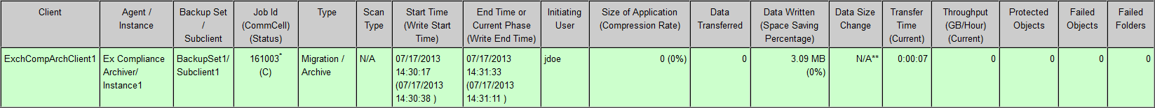

Initiating User
When you select the Initiating User option, the user who scheduled or started the job is listed in the Initiating User column.
archive_job_summary_initiating_user
Setting
To display the name of the user who started the job, on the Selection tab, click Initiating User.

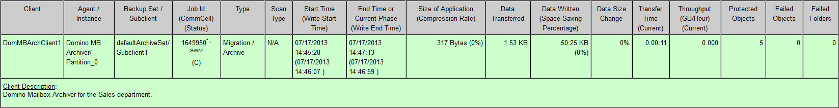

Client Description
When you select the Client Description option, the description that is configured in the Client Properties dialog box appears below each job.
archive_job_summary_client_description
Setting
To display the description that is configured for the client, on the Selection tab, click Include Client Description.

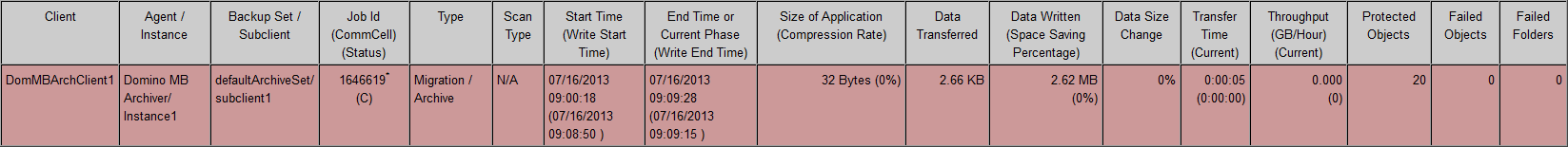

Aged Data
When you select the Aged Data option, jobs that contain aged data are included in the report and highlighted in brown.
archive_job_summary_aged_data
Setting
To include jobs with aged data in the report, on the Selection tab, click Aged Data.
