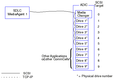

Direct-Attached Library Configuration
The SDLC is connected to the library’s media changer with a direct SCSI. Each MediaAgent communicates with SDLC through the TCP-IP port. In addition, each MediaAgent must also be attached to the drive(s) in the library using SCSI ports.
Within the library, some or all drives must be assigned to the MediaAgents for exclusive use by the CommCell group. The unassigned drives will be available for other applications or another CommCell group.
The following diagrams provide an overview of the hardware configuration required for configuring the ADIC library using SDLC:
Prerequisites - Direct-Attached Library Configuration (1)
Prerequisites - Direct-Attached Library Configuration (2)

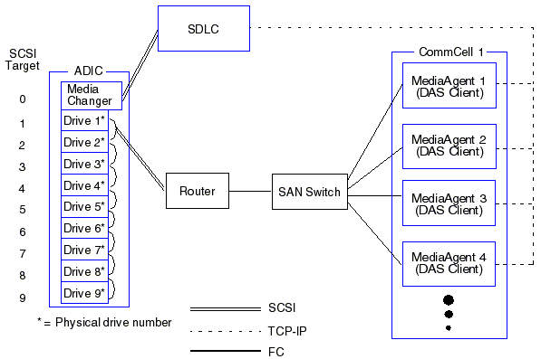

DDS Configuration
n a DDS configuration, the SDLC is connected to the library’s media changer with a direct SCSI. Each MediaAgent in the CommCell group communicates with the SDLC and the drives in the library through the following:
  • MediaAgent to Bridge/ Router/ Gateway using SCSI ports
  • Bridge/ Router/ Gateway to a SAN switch using Fibre Channel cable.
  • SAN switch is connected to all the drives in the library using Fibre Channel cables.
The following diagram provides an overview of the hardware configuration required for sharing an ADIC library among multiple MediaAgents with DDS configuration.
Prerequisites - DDS Configuration (1)
