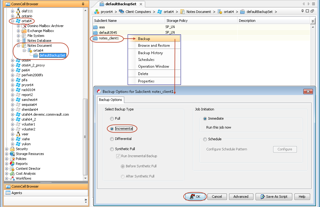

Incremental Backups
An incremental backup contains only data that is new or has changed since the last backup, regardless of the type. On average, incremental backups consume less media and use less resources than full backups.
The illustration clarifies the nature of full and incremental backups.
Follow steps given below to perform an incremental backup:
incremental
  1. In the CommCell Browser, expand Client Computers | <Client> | Notes Documents | <Partition> |< Backupset>.
  2. In the <Backupset> tab, right-click <Subclient>, and then click Backup.
  3. In the Backup Options dialog box, select Incremental.
  4. Click OK.
    In the Job Controller tab, you can track the progress of the job. When the backup has completed, the Job Controller displays Completed.
    incremental - backupklzzwxh:0074otus_notes_docklzzwxh:0075ncremental.png

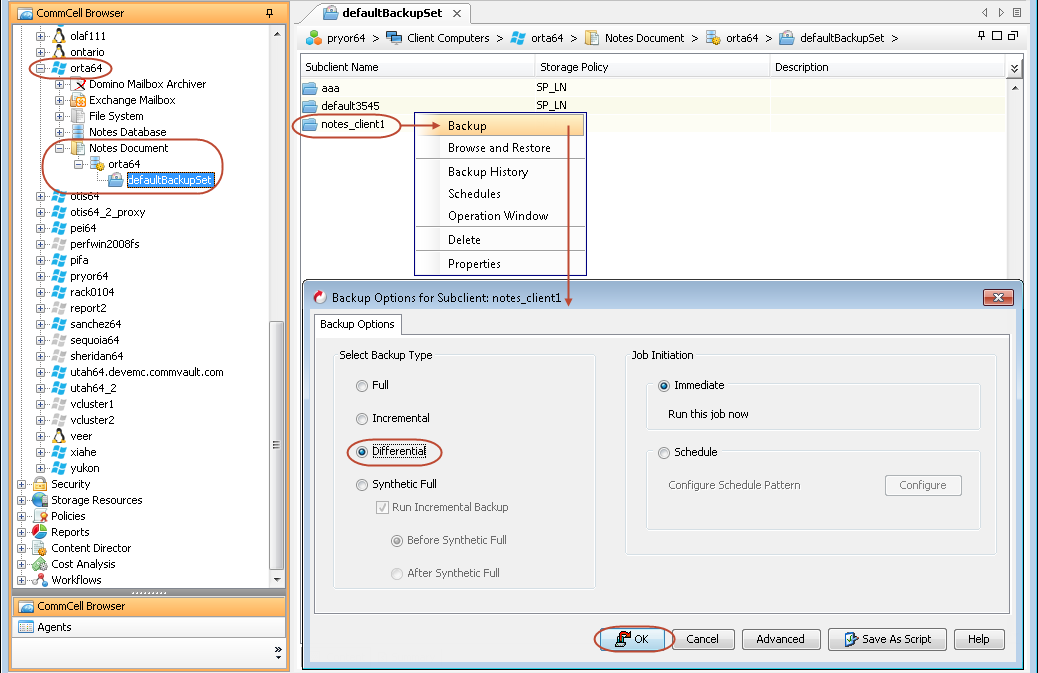

Differential Backups
A differential backup contains only the data that is new or has been changed since the last full backup. Differential backups consume less media and use less resources than full backups. Differential backups are cumulative. This means that each differential backup contains all changes accumulated since the last full backup. Each successive differential backup contains all the changes from the previous differential backup.
  3. In the Backup Options dialog box, select Differential.
  4. Click OK.
    differential - backupklzzwxh:0110otus_notes_docklzzwxh:0111ifferential.png

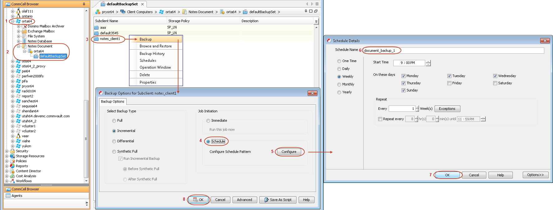

Scheduling a Backup
Follow the steps below to schedule a backup:
  2. In the <Backupset>tab, right-click <Subclient>, and then click Backup.
  3. In the Backup Options dialog box, select Schedule, and then click Configure.
  4. In the Schedule Name box, enter a name for the schedule, and then select the appropriate scheduling options.
    For example:
    Select Weekly, and then change the Start Time to 9:00 PM.
  5. Click OK to close the Schedule Details dialog box.
  6. Click OK to close the Backup Options dialog box.
  7. The backup job will execute according to the options that you selected.
    schedule
