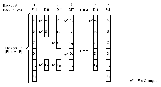

Differential Backup
A differential backup contains only the data that is new or has changed since the last full backup. Like incremental backups, differential backups also consume less media and use less resources than full backups. Differential backups are cumulative. This means that each differential backup contains all changes accumulated since the last full backup. Each successive differential backup contains all the changes from the previous differential backup.
The illustration below demonstrates the nature of differential backups. For simplicity, assume there is a file system that contains six files as represented in the figure.

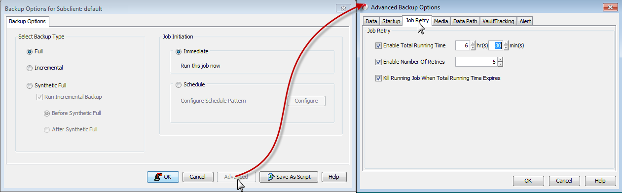

  1. From the CommCell Console, navigate to <Client> | Active Directory | <Backup Set>.
  2. Right-click the Subclient and select Backup.
  3. Click Advanced.
  4. In the Advanced Backup Options dialog box, click the Job Retry tab.
  5. Select Enable Total Running Time and specify the maximum elapsed time before a job can be restarted or killed.
    Select Kill Running Jobs When Total Running Time Expires to kill the job after reaching the maximum elapsed time.
  6. Select Enable Number Of Retries and specify the number of retries.
  7. Click OK.
