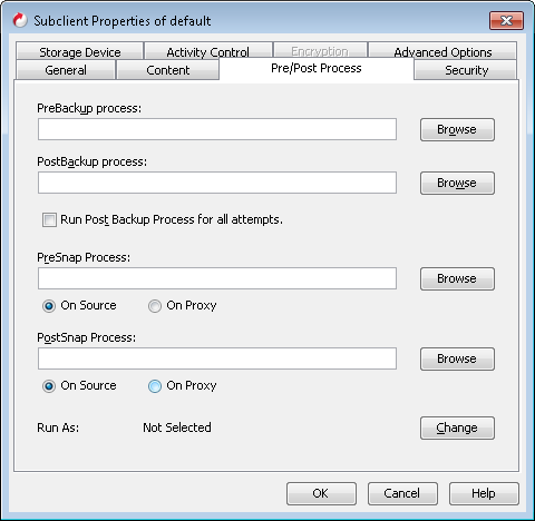

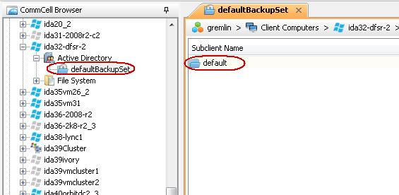

  1. From the CommCell Browser, navigate to Client Computers | <Client> | Active Directory | BackupSet.
  5. Select the batch file or shell script and then click OK.

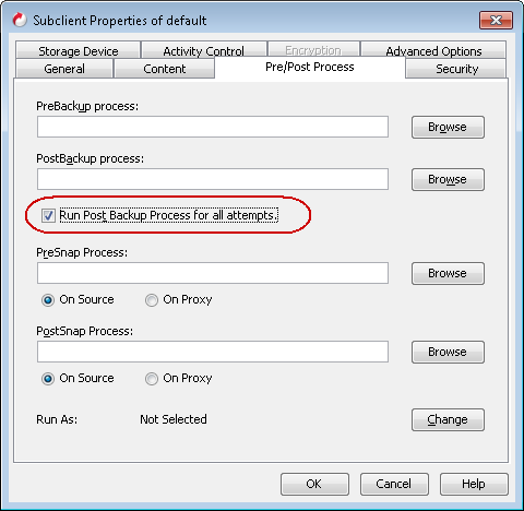

  4. Select the Run Post Backup Process for all attempts check box.
  5. Click OK.

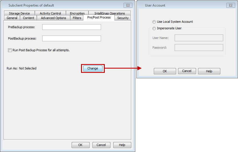

Changing User Account for Executing Pre-process and Post-process Commands
You must specify the user account and password required for executing the pre-process and post-process commands.
  4. Click Change.
  5. Select one of the following user accounts:
    • Use Local System Account - Select this option to use the local system account on the MediaAgent for executing the Pre-process and Post-process commands.
    • Impersonate User - Select this option to use an authenticated user account for executing Pre-process and Post-process commands. However, if the specified user account is not available on the MediaAgent, backup jobs using Pre-process and Post-process commands will fail.
