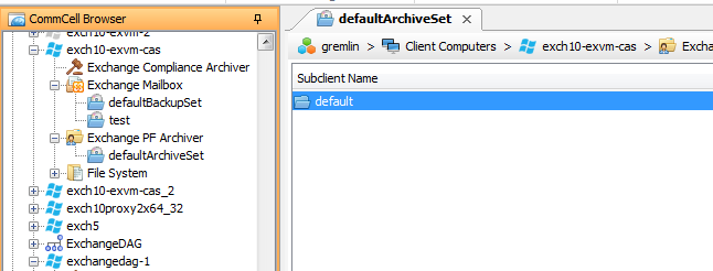

This agent uses the following entities to manage backup and restore operations from the CommCell Console.
Agent: Defines the Exchange Server to be archived.
Backup Set: Facilitates automatic discovery of Public Folders.
Subclient: Defines the Public Folders to be archived.

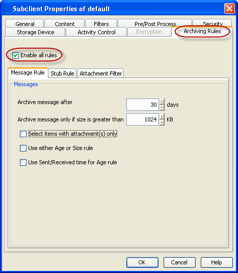

Archiving rules specify the criteria for the type of data to be archived. Messages that meet these criteria are rendered available for archiving if they satisfy any or all the archiving rules.
Based on Message Properties
You can set rules to archive messages based on the messages properties. All the messages that match these criteria will be archived.
  1. From the CommCell Browser, navigate to Client Computers | <Client> | Exchange PF Archiver | <Archive Set>.
  2. Right-click the Subclient, and then click Properties.
  3. Select the Archiving Rules tab.
  4. Select the Enable all rules check box.
  5. In the Archive message after box, type or select the number of days since the message was last accessed.
  6. In the Archive message only if size is greater than box, type or select the size of the message in KB.
  7. Select the Select items with attachment(s) only check box to archive only those items that have attachments.
  8. Select Use either Age or Size rule check box to archive if either the Age or Size of the message or item matches the respective rule.
  9. Select the Use Sent/Received time for Age rule check box.
  10. Click OK.

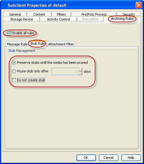

You can set rules to archive messages based on the stub properties. All the messages that match these criteria will be archived.
  5. Click the Stub Rule tab.
  6. Click Preserve stubs until the media has been pruned to preserve stubs until the media has been pruned.
  7. In the Prune stub only after box, type or select the number of days after which the stubs should be pruned.
  8. Select the Do not create stub check box if you do not want to have a stub to be created after archiving.
  9. Click OK.

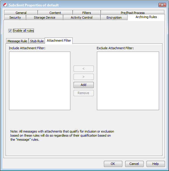

Based on Attachments
You can include or exclude attachments from an archive operation. Use the following steps to configure an Attachment Filter.
  5. Click the Attachment Filter tab.
  6. Click Add, double-click the desired file extension of the attachment.
    • Click Include to include all the attachments with the selected extension in the Archive operation.
    • Click Exclude to exclude all the attachments with the selected extension in the Archive operation.
    • Click Close.
  7. Click OK.
    message_properties_04

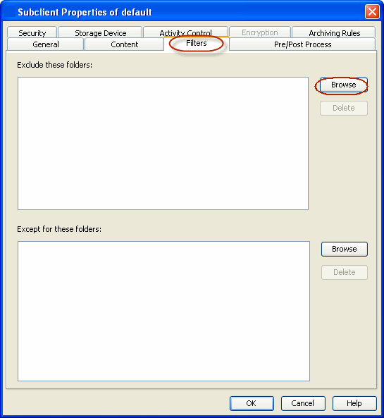

Filter Specific Folders
Use the following steps to exclude folders from archive operations.
  3. Click the Filters tab.
  4. Click Browse next to Exclude these folders.
  5. Select the folders that you want to exclude from archive operation, and then click Add.

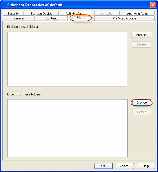

Include Specific Folders
You can include specific folders in archive operations for a subclient in cases where a parent object is listed in the Exclude filter.
  4. Click Browse next to Except for these folders.
  5. Select the folders that you want to include in the archive operation, and then click Add.

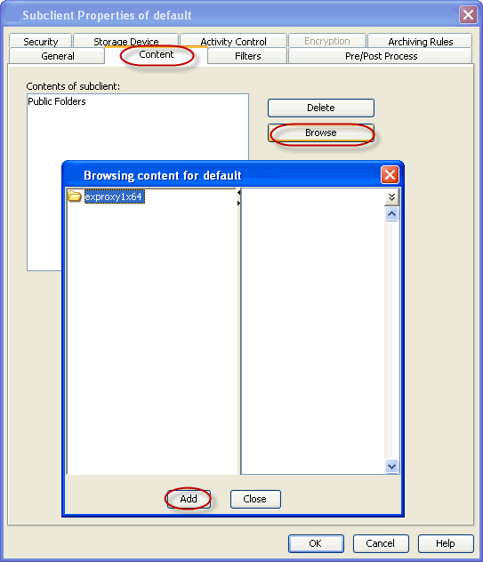

Managing the Default Subclient
By default, all mailboxes are automatically assigned to the default subclient. This default behavior is designed to ensure all public folders are archived.
If you do not want all public folders to be included in the default subclient automatically, you can do so as described in the following sections.
We recommend that you do not modify these settings. Doing so would disable the default subclient's capability to serve as a catch-all entity for mailbox data. As a result, some data may not get archived.
Use the following steps to select the subclient's content for archiving:
  1. From the CommCell Browser, expand Client Computers > client > Exchange PF Archiver > archive_set**.
  3. Click the Content tab.
  4. Click Browse to select the folders you want to archive.
  5. Click Add.
