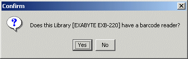

Select the correct button to indicate that the library does not contain a barcode reader. This can be done as follows:
  • Click No in the Confirm prompt asking you whether the library has a barcode reader.

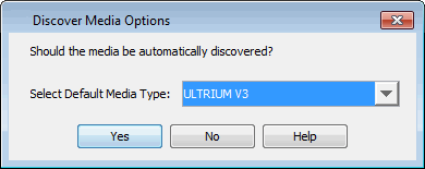

In addition make sure that the correct media type used in the library is selected in the following Discover Media Options dialog box.
