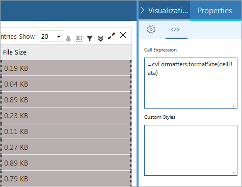

  3. On the Properties tab, click Custom Code custom_code_tab, and then enter your customizations:
    • To add custom code to the entire report, select the Report Name tab, and then in the Custom Java Script box, type JavaScript statements and expressions.
    • To add custom code to a table column, select the table, select the column, and in the Cell Expression box, type JavaScript statements and expressions.
    custom_code_entry
  4. To customize the appearance of the report, in the Custom Styles box, type CSS declarations.
