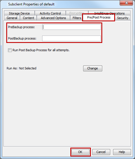

The Pre-process and Post-process commands are executed on the MediaAgent associated with the active drive pool of the storage policy that is assigned to the subclient. Ensure that the required batch files or shell scripts are available on the MediaAgent where the Pre/Post commands are executed.
  1. From the CommCell Browser, go to Client Computers > client > NDMP > BackupSet.
  2. In the right pane, right-click the subclient, and then click Properties.
  3. On the Pre/Post Process tab, depending on the process you want to set up, enter the path of the batch file or the shell script in one of the following boxes:
    • PreBackup Process
    • PostBackup Process
  4. Click OK.
