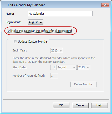

Setting a Calendar as the Default
Initially, the standard calendar is set as the default calendar for the CommCell. Use the following steps to set an existing custom calendar as the default calendar for the CommCell:
  1. From the CommCell Console toolbar, click Control Panel.
  2. Under the Schedule section, click Custom Calendars.
  3. From the Custom Calendars dialog box, select the calendar to be made as default and click Edit.
  4. Select the Make this calendar the default for all operations check box.
  5. Click OK.
config_default_cal

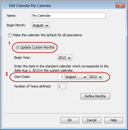

Changing the Start Date of a Month
Once you create a custom calendar with a different start month, you can always change the starting date for the month at a later point in time.
The start date of a custom calendar must be within 15 days prior to or after day 1 of the selected Begin Month. For example, if you select January (2012) as the beginning month, then the start date of the custom calendar can be defined as any date from December 15th (2011) through January 15th (2012).
  4. Click Update Custom Months.
  5. Select the starting date for the month from the Start Date option.
modify_start_date

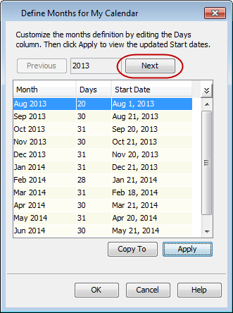

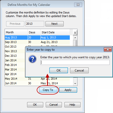

Applying the Custom Month Definitions to Multiple Years
  1. Click Next to scroll to the appropriate year to copy the custom months and then click Apply.
    copy_def_to_year_01
    Alternatively, you can also click Copy To and enter the year to which you want the custom months to be copied. Click OK and then click Apply.
    If there are some years with no custom month definitions in between the currently displayed year and the year specified in the Enter year to copy to window, the last defined year’s custom month definitions will be applied to those years without definitions. For example; the last defined year is 2007, but the currently displayed year is 2006. If 2010 is entered in the Enter year to copy to window, the 2007 custom month definitions will be copied to years 2008 - 2009, while the 2006 custom month definitions will be copied to year 2010.
    copy_def_to_year_02
  2. Click OK twice.

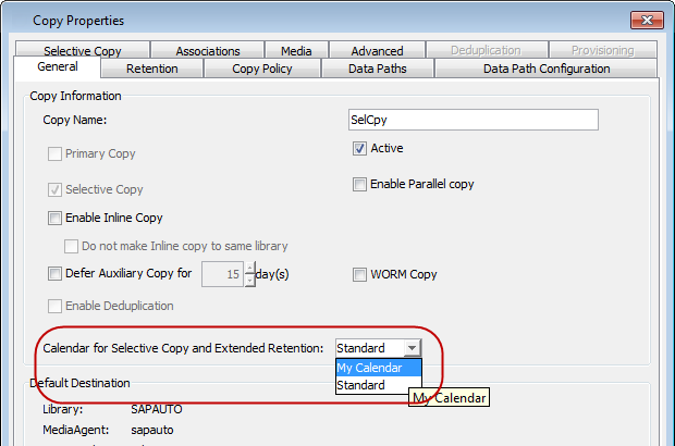

Associating a Custom Calendar to a Storage Policy Copy
Associating a custom calendar to a storage policy copy changes the time intervals by which data is copied to and aged from this copy. Selective storage policy copies associated with custom calendars will have data copied during auxiliary copy operations either monthly, quarterly, half yearly, or yearly based on the days defined in the calendar.
If a storage policy copy is re-associated with a different calendar, the auxiliary copy operation re-calculates the dates in which data is copied based on the time definitions set in the custom calendar.
Use the following steps to associate a custom calendar to a storage policy copy:
  1. Ensure that you have created a custom calendar using the Custom Calendars option in the Control Panel.
  2. From the CommCell Browser, navigate to Policies | Storage Policies | <Storage_Policy>.
  3. Right-click the <Storage Policy Copy> and click Properties.
  4. Select a custom calendar name from the Calendar for Selective Copy and Extended Retention list.
  5. Click OK.
policy_copy_calendar
