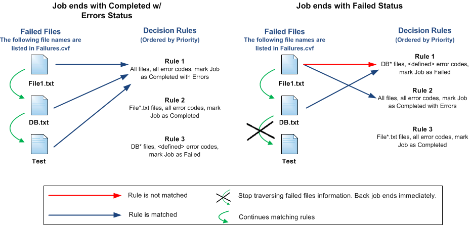

How do the error rules work?
Once created, the agent applies error decision rules first at the end of the backup operation. During this process, the agent traverses the failures.cvf file and determines which are the rules that match (based on priority). The failures.cvf file includes information of all the backup files that failed along with their associated error code.
If the job is not marked as Failed based on the decision rules, the agent continues to traverse the failures.cvf file applying error threshold rules.
The following describes the process for each error rule:
  • In the case of decision rules, when a file and its error codes match a rule, the file is marked with the defined status, and the agent continues to traverse the failures.cvf file. However, if a file matches a rule that will mark the job as failed, the backup job ends immediately with the failed status. The following graph describes the process:
    error_decision_rules
  • In the case of threshold rules, if the number of failed files matches the amount specified in a rule that will mark the job as failed, the backup job ends immediately with the failed status. Otherwise, the agent continues to traverse the failures.cvf file.
