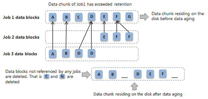

For example, in the following diagram 3 jobs (Job1, Job2, and Job3) are retained in the storage.
Job1 has exceeded retention.
Job2 and Job3 has referenced blocks from a data chunk belonging to Job1.
When data aging job runs, it will determine if the data blocks from the data chunk are being referenced from other jobs. In this case data block C and G will no longer be referred when Job1 is aged and those data blocks will be deleted. All other data blocks will remain in the disk.
