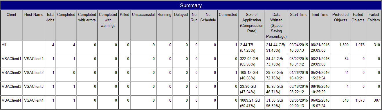

Summary
This table provides information about backup jobs per client.
js_backup_summary
This table includes descriptions for each of the columns in the Summary table, including the client name, number and type of jobs.
Column
Client
Name of the client computer.
Total Jobs
Total number of jobs that ran on the client during the specified time.
Completed
Number of jobs that completed during the specified time.
Completed with Errors
Number of jobs that completed with errors.
Completed with Warnings
Number of jobs that completed with warnings.
Killed
Number of jobs that were killed.
Unsuccessful
Number of jobs that failed.
Running
Number of jobs that were running at the time of the report.
Delayed
Number of jobs that were in a status such as Waiting, Pending, Queued, or Suspended at the time of the report.
No Run
Number of jobs that are scheduled to run, but did not run. Possible reasons that scheduled jobs do not run include:
  • Activity is disabled on the client
  • Multiple conflicting schedules are set for the job
No Schedule
Number of subclients without any backup jobs during the specified time range.
Committed
Number of backup jobs that have been committed. Applies only to virtual server agent backup jobs.
Size of Application (Compression Rate)
Total size of all jobs and percentage of compression.
Data Written (Space Saving Percentage)
Total amount of data written for all jobs and the percentage of space saved.
Start Time
The time at which the first job began.
End Time
The time at which the last job ended.
Protected Objects
Number of objects included in the backup job. For Windows and UNIX File System agents, only files are counted as objects. Folders and directories are not counted as objects.
Failed Objects
Number of objects that failed to back up. Files backed up with the Exchange Database agent are not included in this count.
For Virtual Server Agent, the following events can contribute to the failed objects count: log truncation failing; independent disks not supported; physical RDM disks not supported; and metadata collection failing on all volumes for a virtual machine. Depending on the virtualization platform, other failed objects can be counted as noted in the "What Does Not Get Backed Up" section for the agent.
Failed Folders
Number of folders that failed to back up.

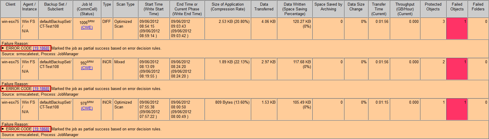

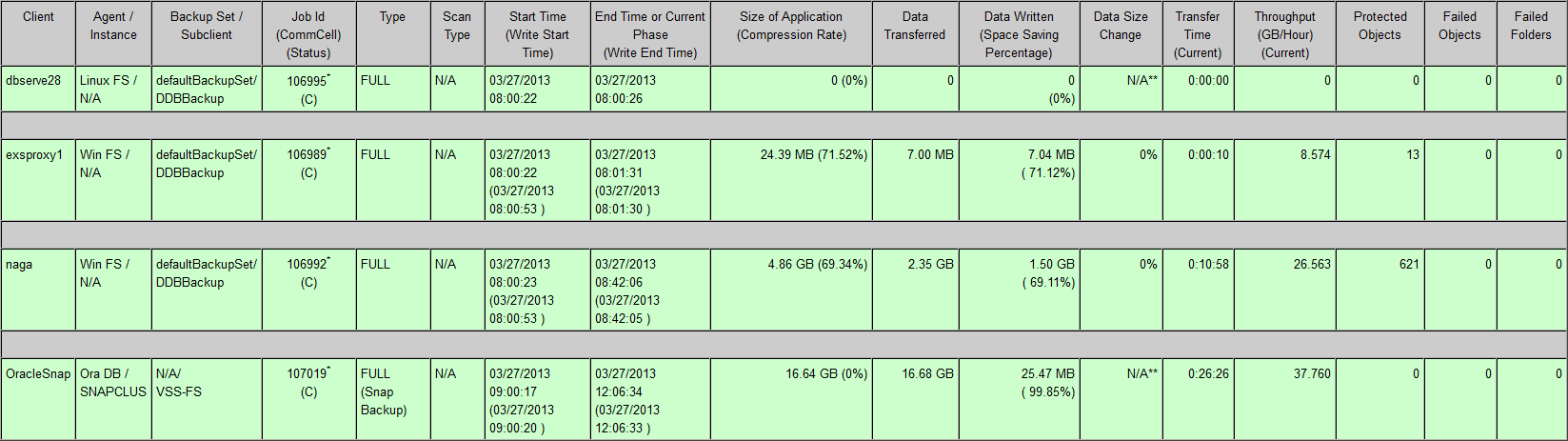

Details
This table provides information about each backup job on each client that matches the selected criteria. The Details table includes up to 10,000 rows of data by default. If you want to see more than 10,000 rows of data, we recommend that you use the Job Summary Report (Web) instead.
The following columns are included in the Details table by default.
js_bu_details
This table includes descriptions for all of the columns in the Details table.
Column
Client
Name of the client computer on which the backup job ran.
Agent/Instance
Type of agent and name of instance on which the backup job ran.
Backup Set/Subclient
Name of the backup set and subclient on which the backup job ran.
Job ID (CommCell) (Status)
ID number for the backup job and the status of the backup job.
Type
Type of backup. For example: Full, Incremental, Differential.
Scan Type
Indicates the type of scan method that is configured for the backup set on which the job ran.
Start Time (Writer Start Time)
Date and time at which the backup job began.
End Time or Current Phase (Write End Time)
Date and time at which the backup job ended.
The original size of the data before compression and the rate at which data was compressed during the backup job. The size of archive index files is not included in the compression rate. The Compression Rate is calculated using the following formula:
Compression Rate = 100*(Uncompressed Data Size – Compressed Data Size)/ Uncompressed Data Size
Data Transferred
Total size of data that was transferred from client to media during the backup job. This number will be low if Deduplication is configured on the client.
Amount of data written in kilobytes (KB) and percentage of space saved during the backup job. This includes the size of archive index files.
Data Size Change
The percentage of data that changed between the last backup job and the most recent backup job of the same type. For example, the percentage of data between the last full backup and the most recent full backup.
Transfer Time (Current)
Amount of time it took to transfer the data from client to media.
Throughput (GB/Hour) (Current)
The amount of data backed up per hour during the transfer of data from client to media. The calculation for Throughput is: Size of Application / Transfer Time.
Protected Objects
Number of protected objects included in the backup job. For Windows and UNIX File System agents, only files are counted as objects. Folders and directories are not counted as objects.
Failed Objects
Number of failed objects included in the backup job. Files backed up with the Exchange Database agent are not included in this count.
Failed Folders
Number of failed folders included in the backup job.
Failure Reason
This section appears for each job that includes an error. Information includes the following:
  • Job error code
  • Description of the error
  • Source and Process related to the error
js_bu_job_error_code
