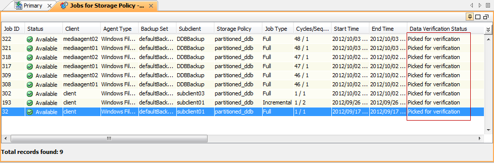

View Jobs for Data Verification
  1. From the CommCell Browser, expand Policies | Storage Policies | <Storage Policy>
  2. Right-click the appropriate storage policy copy, point to View, and then click Jobs.
  3. From the Job Filter for Storage Policy dialog box, clear the Specify Time Range check box and then click OK.
  4. The list of jobs that ran to this storage policy copy is displayed in the Jobs for Storage Policy window.
    The status of the jobs that are selected for verification displays Picked for verification in the Data Verification Status column.
    view_dv_jobs

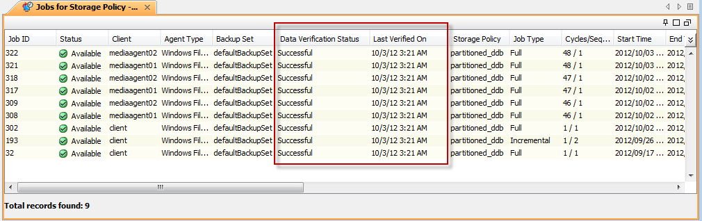

  4. After completion of data verification job, perform the following to view the status of the verified jobs.
    1. Right-click the appropriate storage policy copy, point to View and then click Jobs.
    2. From the Job Filter for Storage Policy dialog box, clear the Specify Time Range check box and then click OK.
      In the Job for Storage Policy window, the status of the jobs under Data Verification Status column is displayed as Successful.
      view_jobs_after_verification
